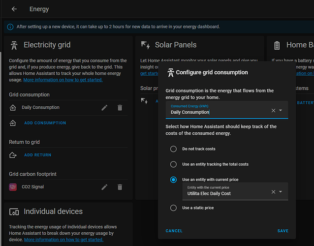

Now you should be left with something like this…
UtilitaTariff_DailykWh = How many kWh until it goes to the second Tariff
UtilitaTariffRate1 = Price of Tariff #1
UtilitaTariffRate2 = Price of Tariff #2
Utilita Elec Daily Cost = This will show the current Tariff rate and can be used to track the price
Final Step - Configure the Grid Consumption to use the Utilita Elec Daily Cost
