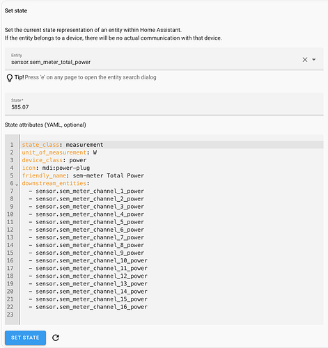

I have been considering a simple suggestion that might be workable: Add a new YAML dictionary attribute to the Utility Meter helper defining a list of “downstream” entities. The state value of the utility meter is unaffected and downstream entities may or may not sum up to that value (any remainder representing “other” in a Sankey chart). Is this over simplifying?
Edited to add: thinking about this further, custom attributes can be added today… we could just invent a “standard” attribute which could be used by Sankey or other HACS graphs to automatically plot the relationships (de-duplicating the energy dashboard would have to come later). My example customize.yaml:
sensor.sem_meter_total_power:
  downstream_entities:
    - sensor.sem_meter_channel_1_power
    - sensor.sem_meter_channel_2_power
    - sensor.sem_meter_channel_3_power
    - sensor.sem_meter_channel_4_power
    - sensor.sem_meter_channel_5_power
    - sensor.sem_meter_channel_6_power
    - sensor.sem_meter_channel_7_power
    - sensor.sem_meter_channel_8_power
    - sensor.sem_meter_channel_9_power
    - sensor.sem_meter_channel_10_power
    - sensor.sem_meter_channel_11_power
    - sensor.sem_meter_channel_12_power
    - sensor.sem_meter_channel_13_power
    - sensor.sem_meter_channel_14_power
    - sensor.sem_meter_channel_15_power
    - sensor.sem_meter_channel_16_power
sensor.sem_meter_channel_5_power:
    - sensor.wifi_plug_f31e_energy_power
    - sensor.wifi_plug_outdoor_bd00_energy_power
sensor.sem_meter_channel_6_power:
    - sensor.wifi_plug_3eb6_energy_power
sensor.sem_meter_channel_7_power:
    - sensor.outlet_livingtv_energy_power
These attributes are now available to use in custom cards or automations:
