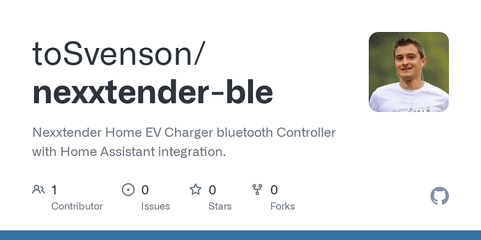

Hi All,
Feel free to give this a try:
No guarantees, but working without any issues here for a year. ![]()
Feel free to join, the ESP code is already working and tested
