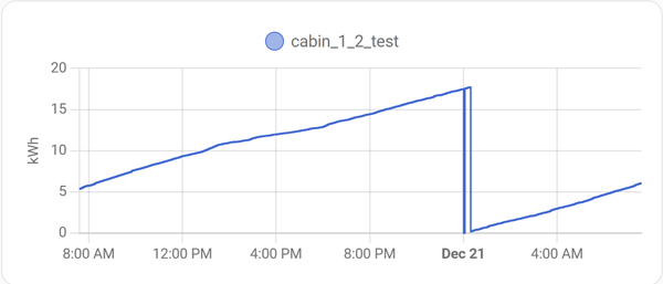

I have a screen capture of an energy graph card, (type: energy-devices-graph) and an entity card, on the same dashboard.
The energy graph card relies on the same sensors as the entity card. The Cabin L1+L2 sensor, (sensor.cabin1_cabin2) is a template sensor:

Clearly, the stored values are correct or the entity card would be wac too.
Two days ago I was able to tinker with statistics and get it working for the rest of the day. But the next morning it was back to negative values.
Last night I deleted the template sensor and recreated it with a new name and unique ID. It worked perfectly as soon as it was saved. At midnight I verified that the graphs on my dashboard were all blank waiting for the 1:00 AM refresh and went to bed. This morning, negative value equal to yesterday’s usage less today’s usage.
Other threads on the topic suggest it has to do with the timing of daily resets at midnight. While that sounds plausible, how did that happen? How do I change that? Why can’t I create a template sensor that just stays in sync? I want to display the sum of two sensors like one. Is there a better way to do that than a template sensor?

I wonder if this is a clue? How do I figure out what are the two events depicted at 00:00:00 and 00:18:00? Do I have any means to control when those events take place?

The problem is not limited to energy graphs. An ordinary statistics graph referencing a template sensor also starts the day with negative yesterday’s sum. From what I can tell it isn’t a bug and it isn’t a feature. It’s just a limitation.

Finally, to explain the behavior you are seeing: The template sensor you created has a state class of “total” which affects the statistics that are generated for that entity. HA will create state and sum statistics for that entity, and the sum is calculated assuming that the value can increase or decrease. So a reset is interpreted as a large negative spike that is subtracted from the running sum.
Also, you seem to be confusing the state of the entity with its statistics. Those are different sets of values stored in different tables in the database. It can be very confusing because the graph you see when you click on an entity will be from the statistics table, but if you click on “show more” you’ll see the data from the states table, which is the “normal” history. Unless you change to a date range that is earlier than your oldest history, at which point data will be pulled from the statistics table.
