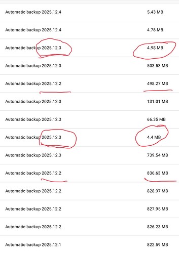

I noticed that it must actually be related to an HA backup.
If I imported an HA backup the day before, the data is then corrupted.
See screenshots, you can see it based on the HA version.
