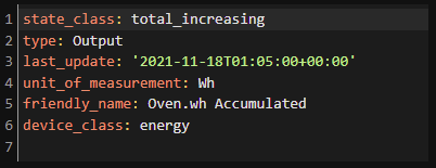

Anyone else have issues adding an Iotawatt calculated output to the Energy dashboard?
I created the outputs as described in the official HA docs but HA won’t let me add the accumulated Wh entities. As far as I know they have the correct attributes.
The only thing different I see compared to mine is yours has Type: Output but mine has Type: Input
That’s just because my example entity above is a calculated output from the iotawatt rather than one of the hard-wired inputs.
Input example:
One thing I’m thinking though is that my entities are in Wh rather than kWh… It seems the Energy dashboard might only accept kWh? Even though the HA docs don’t say we need to create a conversion for the iotawatt sensors.
No I found this one that appears in the drop down list of the energy configuration. I have lots that are Wh
Well then I have no idea why I can’t add any of the iotawatt entities to the Energy dashboard then. It’s odd because I’ve simply followed the HA docs… It was easier using the custom component :thinking:
Yeah not sure sorry. Im not using the offical add-on… Maybe try the Iotawatt thread as you did before?
Yeah, I just didn’t want to spam it too much with issues relating to the core integration since that thread is for the custom one. Will try anyway
