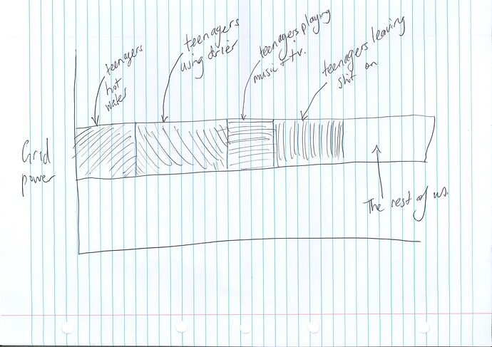

In the energy management, I get my data partly from a pulse reader, attached to my electricity meter that the electricity company uses for billing me. And partly from individual devices, connected to smart plugs.
I really like the visualisation with the bars, showing how much has been consumed per hour/day/week etc.
However, I want the bars to concist of what’s been consumed TOTALLY (read from my energy meter) and how much of these bars have been consumed by individual devices. If i add individual devices as “Grid consumption”, sure enough they show up, but they make the totally consumed energy statistics wrong. Since they are already being accounted for in the reading from my electricity meter, they don’t need to be “added to the bar” again as extra consumption. I only want the bar to be broken down. For example "Hour x, total consumption from electricity meter: 10kWh
These 10kWh concists of 1kWh from freezer, 1kWh from cooler, 1kWh from dishwasher, 7kWh from googling HA energy setup".
In this way, it will be way more graphical and intuitive too see what’s been pulling electricity and when.
The consumption of individual devices that are shown under “Sources” does not provide a good graphical visualization and makes it harder to see how much a given device has “contributed” to the total consumption. If the bars could include how much an individual device has “contributed” to it, it would be way better.
I try to add a picture, perhaps some good soul will understand what i’m trying to say :slight_smile:
Don’t add your household devices to grid consumption, add them as individual devices.
Thank you for your reply. I do have the devices added individually, but their consumption does not show up graphically on the bars. Would be a really helpful functionality if it did. Perhaps it can be solved?
Looks like you added your devices to the grid section instead of the devices section.

I have a Shelly EM and I am now using it to track my heat pump electricity consumption.
I would like to split my energy dashboard bar chart between household use and heat pump use.
Other than creating a custom Grafana chart, I can’t see any other way to do this at the minute.
It should be something easy for HA to add in though as you could just select a tick box when adding a meter to grid consumption to ‘not add consumption to overall’
It would also be great if we could show this as a separate icon like the solar production on the little graphic.
