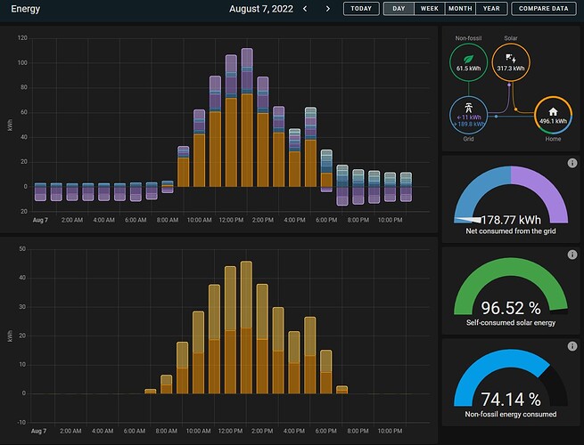

I just set this up a few days ago, but the results are way off.
This is my summary from yesterday:
The solar output of 317 kWh is spot on and matches what my inverters reported within 1%. However, my home did not consume almost 500 kWh.
Here’s a high level diagram of my electrical layout with the main CTs, along with my actual Source readings yesterday from the CTs:
This is how I have those 8 CTs configured:
They are currently all reading positive watt amounts, except the Grid CTs will read negative values when I’m pushing power into the grid. Here are the actual readings in watts from around noon yesterday:
So do I need to flip some of the CTs around in order for the Energy panel to show the proper Net consumption for my Home? Right now HA is summing my Solar total with my Grid total. It should be subtracting the Solar total from the Grid total, no?
I’m using this integration for my CTs:
And this one to convert the readings to something that the Energy panel can consume:
Thanks!
I have updated my power flow diagram for my situation as follows:
It is clear that the entities measuring the energy produced would go under Solar Production as noted above.
I would have also thought that Grid Consumption would be the feeders to my sub-panels where the current always flows towards to loads. I have marked those accordingly above.
So that leaves Return to Grid. As noted above, current can flow in both directions depending on how much energy I’m producing at a given time. In reading through the previous posts, at around post # 1075, it was suggested to create a rule so that when current flows into the grid, it is counted as Return to Grid and that when I’m consuming more than I produce, it is marked as Grid consumption.
Is that what I need to do in my situation to make this Energy flow work out?
I threw together a quick dashboard showing my readings during the day for the above CTs:
I would really like to get this working, but I guess I need to better understand what sensors go where when configuring the Energy dashboard.

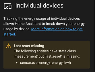

After the 2022.08 release i‘ve successfully added an eve energy plug per Homekit Controller.
Basically is the device working and shows energy consumption but with a lot decimals
How can i adjust how the values are displayed for instance with only two decimals like 8.00 W
In addition i got an error after i‘ve added the device to the energy dashborad
But i have no idea what to do in order to solve it?
I don’t think you change the number of decimals displayed yourself. You could create an additional template sensor based on this one, where you filter this entity with round(2) to get 2 decimal places.
The state class for energy measurements should probably be “total_increasing”. You can also fix that with a derived template sensor.
You should probably report this to the integration authors.
