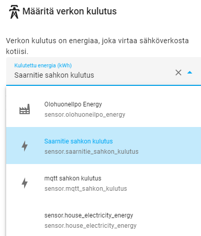

Energy consumption uses sensor.saarnitie_sahkon_kulutus as sensor.
sensor.saarnitie_sahkon_kulutus has value:
Still not getting any data on energy dashboard.

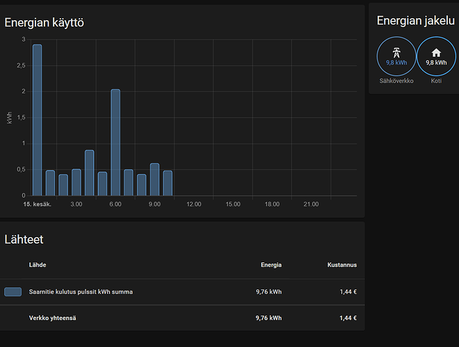

OK, now i’m getting values. But these setting are not right for my energy sensor. I’m counting led blinks from energy meter and then calculating what the measured number of pulses means as kWh. The calculated value is sent through mqtt to HA sensor every 60 seconds. So the state_class: total is not right.
If I change my mqtt sensor and sensor.saarnitie_sahkon_kulutus state_class back to measurement,
then I get error on my energy dashboard settings page, that sensor is missing last_reset.
This I do not understand, since measurement state_class is current value. Why should that have last_reset???
With state_class: measurement I do not get any values to energy management page??
So, experimenting continues, or does anyone have solution to my problem?
I have solved this another way. Now I get the number of pulses (led blinks) from my energy meter to a mqtt sensor in HA. Then add these pulses to ( 1 pulse is 1 Wh so I divide by 1000 to change unit to kWh) utility meter and use that as energy management source.
So I think this problem is solved. I thank everyone who answered to this topic. Each answer took me further on solving the problem.
