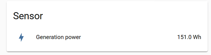

I’m pulling almost my ‘hairs’ out for not getting this to work. Please advise what I do wrong:
Config:
homeassistant:
  customize_glob:
    sensor.*_power:
      last_reset: '1970-01-01T00:00:00+00:00'
      device_class: energy
      state_class: measurement
  - platform: mqtt
    state_topic: "solarmanpv/station/generationPower"
    unit_of_measurement: 'Wh'
    device_class: 'energy'
    state_class: 'measurement'
