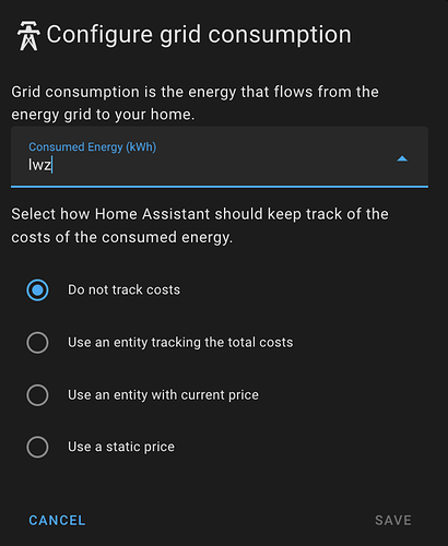

Energy: Not showing the expected entities for consumption
Who can help me adjust my settings here? I’m really stuck for day now.
I just want my dashboard with energy meter showing in W instead of kW.

I am clueless what is going on in my configuration. I have two scrape sensors:
  1. from my inverter: (Energy income)
  - platform: "scrape"
    unique_id: "tarpit_sofar_inverter_shed_today"
    authentication: "basic"
    username: "admin"
    password: "***"
    resource: "http://192.168.178.5/status.html"
    select: "script"
    index: 1
    value_template: '{{ (( value.split('';'')[6] ) | replace (''var webdata_today_e = '','''')|replace(''"'', '''')|float )}}'
    scan_interval: 300
    unit_of_measurement: "kWh"
    device_class: "energy"
    state_class: "measurement"
  1. my heat pump (Energy consumption)
    unique_id: "tarpit_lwz_p_heizung_tag_scrape"
    resource: "http://192.168.178.4/?s=1,1"
    select: ".value"
    index: 23
    value_template: '{{ value.replace("kWh", "").replace(",", ".") | float(default=0) }}'
    scan_interval: 60
The first sensor shown up inside the energy dash board, the second does not.
inverter:
lwz: (heat pump)
I don’t understand the difference between these both sensors, can somebody help?
