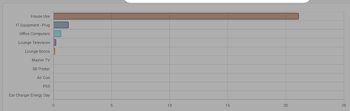

Not sure what the issue is but I have recently noticed an error in which my Energy graph (energy Dashboard) is showing double the value on the selected field.
It only seems to be recent but im perplexed as to how it has two different figures showing for the same thing?

So looking into this further after getting some time, I still seem to have an issue.
It looks like the house_use figure is including the Car Charger Energy Day figure within it, when it should be deducting it based on the sensor.house_total_load sensor.

I would assume the fact the sensor sensor.myenergi_zappi_energy_used_today is incorporated as part of the House Total Load it should deduct it from the Home Use total, but it doesn’t seem to be?
