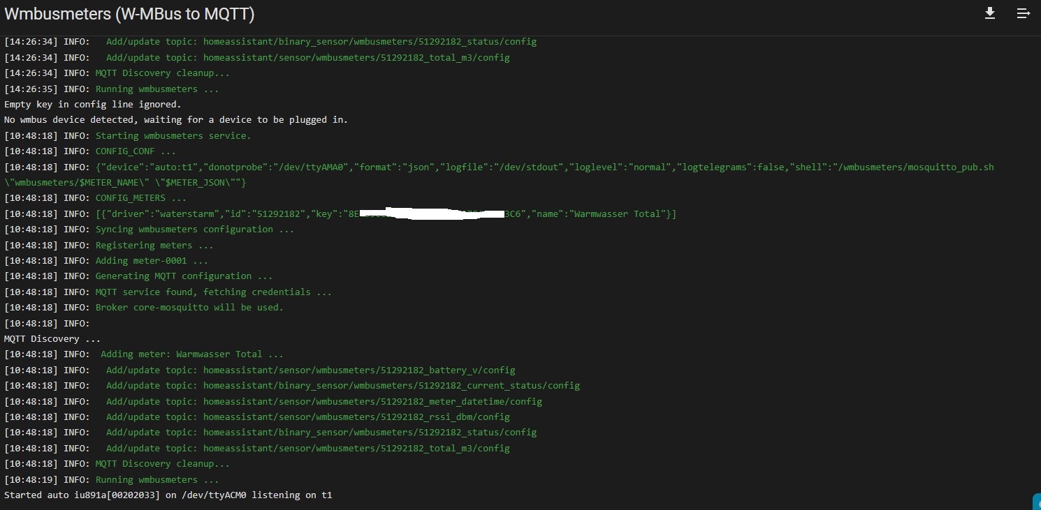

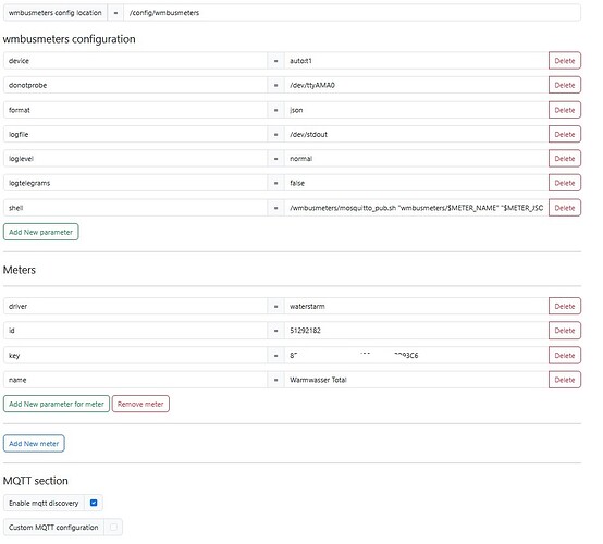

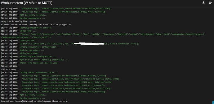

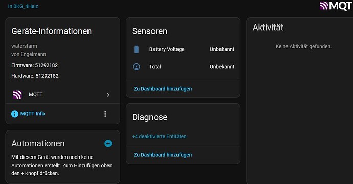

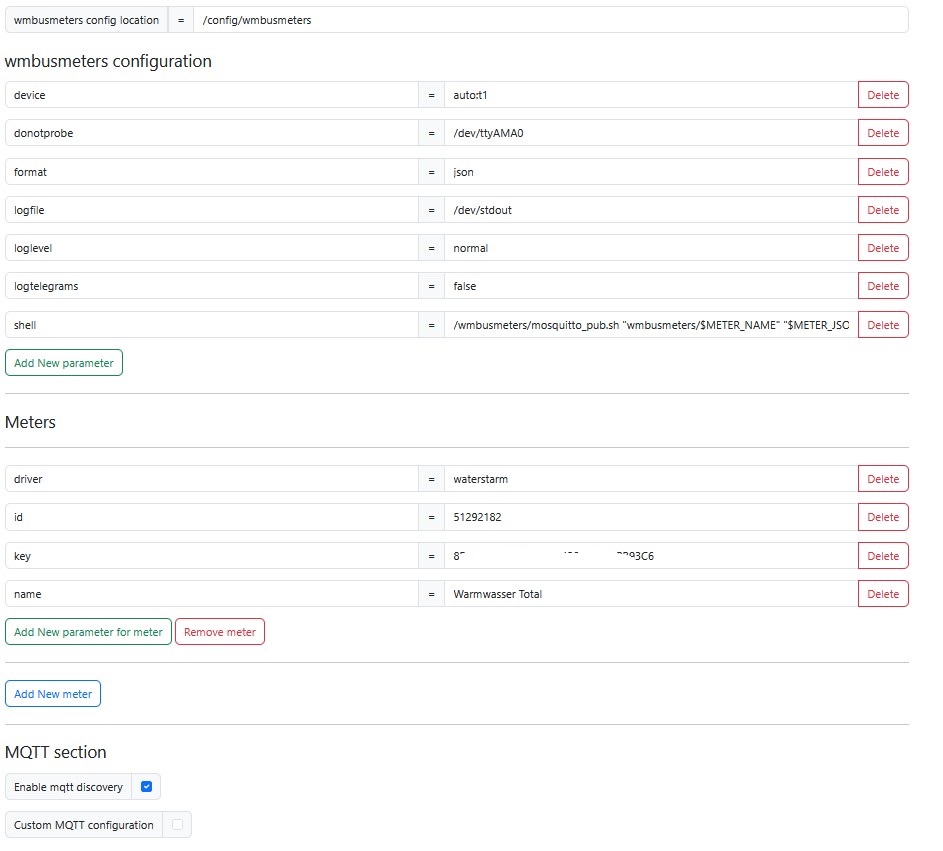

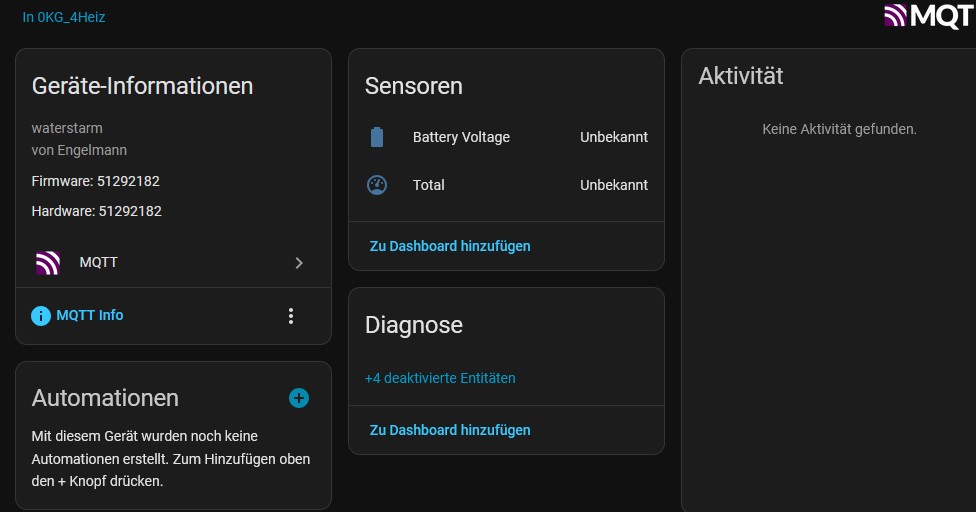

Hi, sorry for entering this topic but I also use an engelmann watermeter and an USB Stick IMSt iU891A-XL with wmbusmeters but don’t succed to receive values.
Could anyone tell me how far I came? Do I have a connection to the meter?
What to do to get values? My information is that the communication of the meter starts automatically after 34L run through what allready happened.
