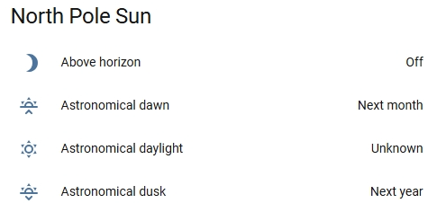

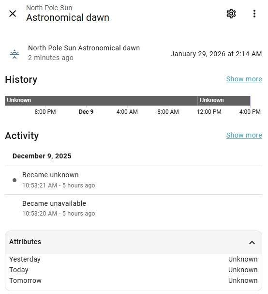

I just did a quick implementation that will search ahead up to one year to look for the next “event” (dawn, dusk, etc.), and this is what it looks like for one of the test locations I made:
Note that the yesterday, today & tomorrow attributes show the “raw” values (i.e., not affected by this change.)
