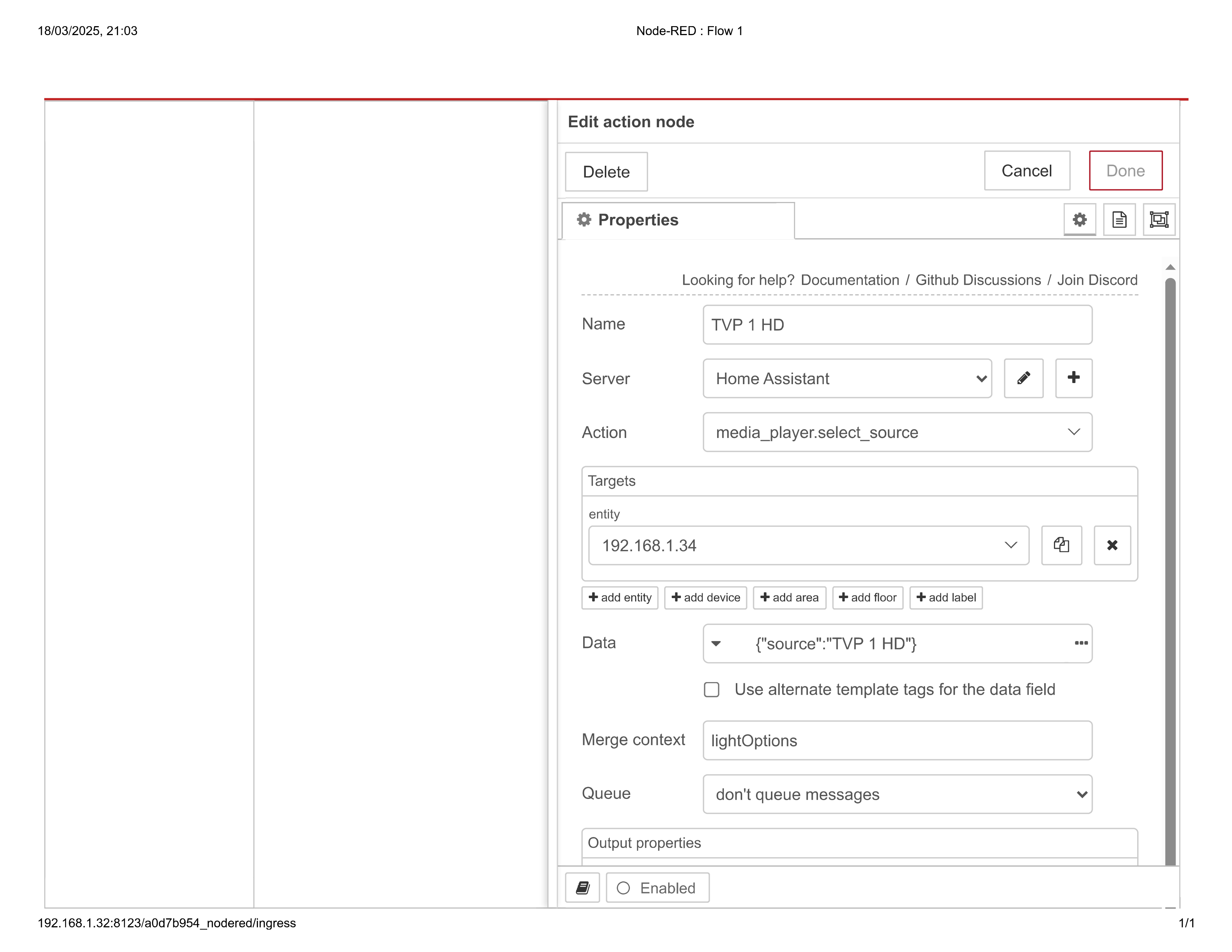

Now configure your “virtual device”
.name: “the one you will see on Alexa and to which you will give the orders”
.connection: your account
.type “Here you have to put: Entertainment Device”
And we need to change only the “entity” of our media player with double click we edit and select ours:
.Set Volume to… {media player}
.Set Channel to… {media player}
Once everything is configured, we click deploy (to save the changes)

I did all the steps in DelBierzo’s guide and…
Only the volume setting worked: Set Volume to… {media player}
Then I made a few changes:
  1. In: Power on {shell command} – Action - changed to: media_player.turn_on
    Works great.
  2. In: Power off {shell command} – Action – changed to: media_player.turn_off
    Works great.
  3. In: Volume down {shell command} – Action – changed to: media_player.volume_down
    Works great.
  4. In: Volume up {shell command} – Action – I changed it to: media_player.volume_up
    Works great
  5. In: Channel down / previous channel {shell command} – Action – I changed it to:
    media_player.media_previous_track
    Works great.
  6. In: Channel up / next channel {shell command} – Action – I changed it to:
    media_player.media_next_track
    Works great.
  7. However, I have a problem with: Set Channel to… {media player}
    Here, to make something work in – Action- I entered: media_player.select_source
    And in: - Data – I entered: {“source”:“Cartoon HD”}
    This causes that using the command: Alexa switches to channel 5 on “virtual device name”
    only starts this one Cartoon HD channel
    The Cartoon HD channel will start when calling any channel number.
    Question: How do I get the Alexa command switches to channel 5 on “virtual device name” to work correctly?
Kind Regards.

Since this is my first time with Node-Red, I needed some time to get familiar with the basics. The debug feature turned out to be crucial. Thanks to it, I saw what was happening on the ChangeChannel output. And here is the solution:
When you say it’s not working set channel change, i think you mean change it using the channel name to change it.
If you set change with channel number, shouldn’t have any problems.
data: json
{ "media_content_id": "{{payload.channel}}", "media_content_type": "channel" }
Thanks for sharing your solution, switching to using the channel name, although it may be a real madness to configure each channel in this way, but it is a good solution, for those that we use most daily or for a specific one.
With a little patience and desire, it’s a matter of trial and error, and in the end it works.
Good job.
I have been looking for a solution to control enigma2 with voice for a long time. When I came across your post I quickly started testing the solution. Only later did I realize that this thread concerns third party integration enigma 2 and I do not have one. Thanks to your idea my fixes work on the standard HA configuration.
The changes I provided allow you to call channels using the command: Alexa switches to channel 5 on “virtual device”
Thanks.
