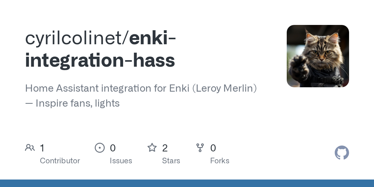

Hello
Given that Cyril's activity on GitHub seems to be very sporadic, I'm working on another version of the Enki integration for Hass. My goal is to integrate, at a minimum, all the accessories I have (light bulbs, outlets, sirens, door/window and motion sensors, thermometers, etc.).
Here's the link if anyone would like to check out the repository.
I'm taking this opportunity to gradually review the code architecture to make it cleaner.
Please feel free to contribute; I'll do my best to incorporate your pull requests.
Hi @bbird,
Good question… the confusion probably comes from two repos and two Cyrils :sweat_smile: (I’m not @CyrilP, same first name, different people).
I opened CyrilP/hass-enki-component#78 to align with him: broader device support, unify the differences between codebases, stop duplicating fixes across two trackers. He confirmed he’s fine pointing to one canonical repo and archiving his when ready.
For your Lexman solar inverter, cyrilcolinet/enki-integration-hass is where that work lives — check_power_production / check_energy_production are supported, regular releases (latest v1.6.14), HACS custom repo.
If something’s missing on your setup, opt-in telemetry can send an anonymized device profile (no account IDs) and pre-fill a GitHub issue — straightforward way to add hardware not covered yet.
Your PR is welcome there if you still have it.
