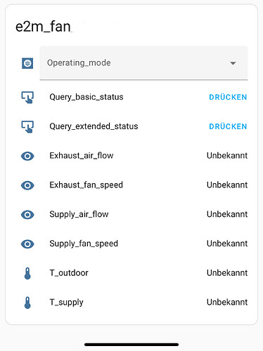

I have here some room ventilation systems. They are not known to the python lib used by the enocean integration.
Is there a way to edit the used “EEP.xml” in my Home Assistant Operating System environment?
Hi, I am in the same boat as you (two Dimplex DL 50 WE2).
Have started to edit the EEP.xml in a separate manual installation of the python enocean lib on pc. Want to try it out on dev pc before changing anything in homeassistant. There in Linux mint env it is under /usr/local/lib/python2.7/dist-packages/enocean/protocol/EEP.xml
So far still adding entries based on the D2-50-00.pdf/xml and not knowing if anything of it will work.
