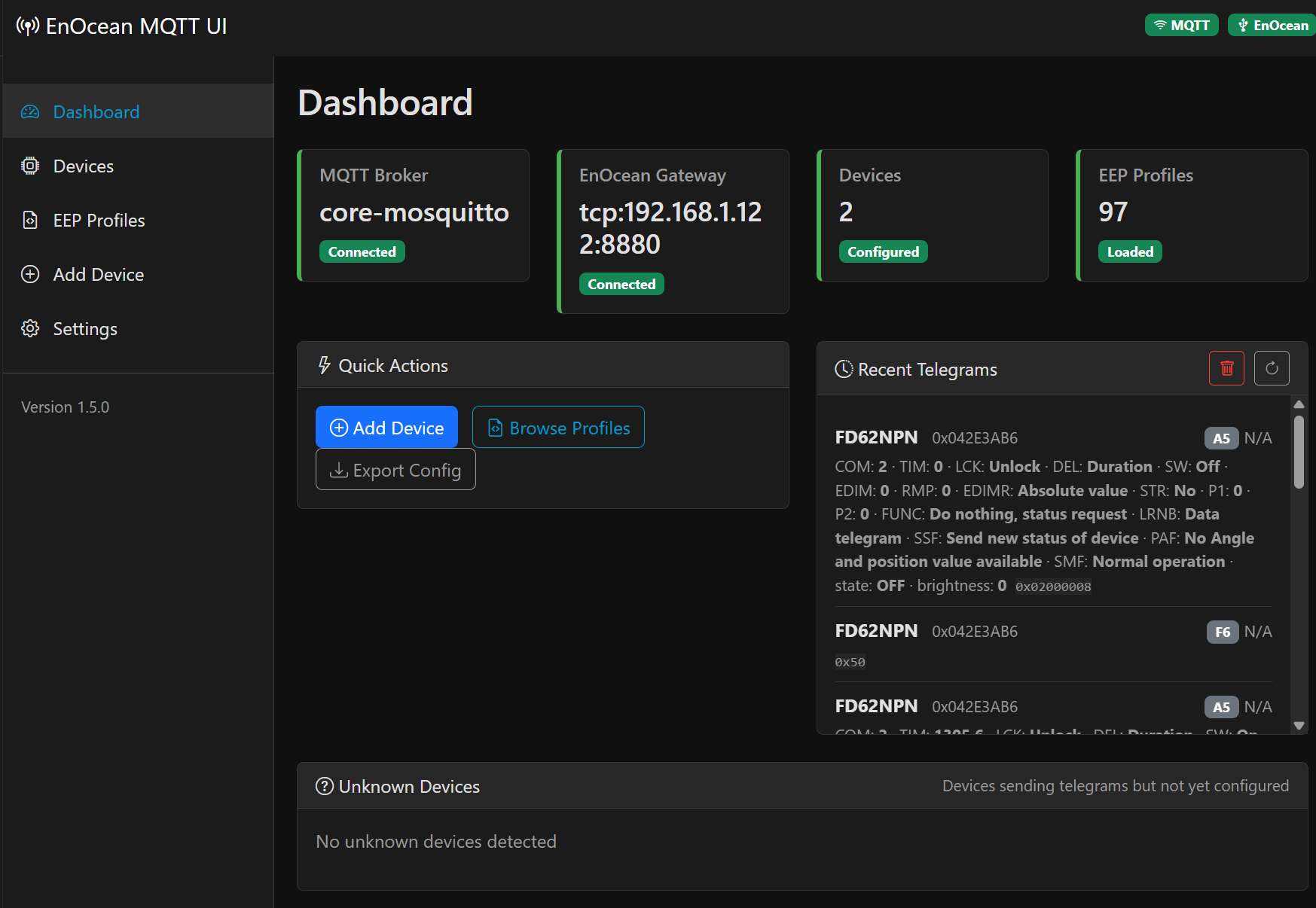

Hi all,
over the last months I built an EnOcean-to-MQTT App with a web UI: devices are added via teach-in (or manually), EEP profiles can be browsed and edited in the browser, and entities show up in HA via MQTT discovery. No YAML editing needed.
Background: some of my devices (e.g. a Kessel Staufix) don’t follow the official EEP spec, so the App lets you fork a standard profile and adjust fields and entity mappings in a visual editor. It also supports Eltako actuators (dimmer/switch/blinds) including teach-in, a live telegram monitor with decoded payloads, and config export/import.
If you prefer YAML-based configuration, the established enocean-mqtt add-on by ChristopheHD is still the way to go — his EEP.xml database is also the basis for my profiles.
Repo: https://github.com/ESDN83/HA_enoceanmqtt-addon-ui (current version 1.5.2)
Feedback is very welcome, especially from people with device types I don’t own myself.
