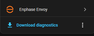

The evaluate what is going on I would need the HA Enphase_Envoy Integration diagnostics file and the HA log file with some hours of runtime with the Enphase_Envoy Integration. I don’t think you can post them here in a comment as files (don’t paste the comment as text in a comment) so send them in a DM. Or open an issue in for enphase_envoy in github.
To get the diagnostics file use the download diagnostics on the enphase_envoy device page

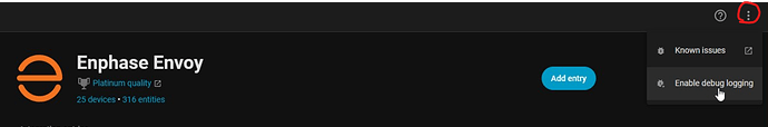

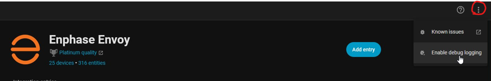

To enable debug logging for the Enphase_Envoy, go to the Integrations page, select Enphase Envoy and use the menu at the right hand top.
Let it run for couple of hours and disable debug again using same menu. That will then download the current HA log file. Remove anything you don’t want to share from it, but leave the enphase debug lines in. If tight on disk space on your HA device, keep an eye on it.

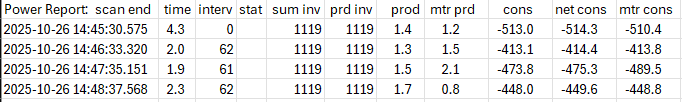

Looking at the data I can confirm that the production values are below 2 for the collection period.
Below picture shows the values send by the Envoy in a few different reports.
  • sum inv: the power reported by the individual inverters from /api/v1/production/inverters. This data may be between 0-15 min old. Sum of 5 inverters each reporting 200 - 225 Watt. Seems realistic number.
  • prd inv: also sum of inverters but from /production report, same value as sum inv
  • prod: value of the production current transformer from /production. This value is below 2.
  • mtr prd: value of the production current transformer from /ivp/meters/readings. This is typically source for previous mtr prd with some minimal time differences and also below 2.
  • Other columns are consumption values from same reports.
This is the raw data from the Envoy (and what you actually see in Home Assistant).
Seems to suggest that something is not correctly configured for the production current transformer. Almost as if it is reporting in kW rather then W, although that is just guessing.
And from your experience, have you seen someone else reporting this?
No not really. We’ve seen reports for Envoy-metered without actual CT connected that had some unexpected behavior, but yours shows connected CT.
That’s why I have some suspicion about how the setup/configuration of the production CT or a quality issue of the CT. But as said, it’s a bit guessing.
