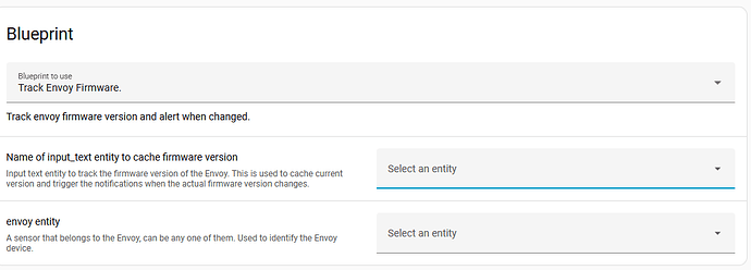

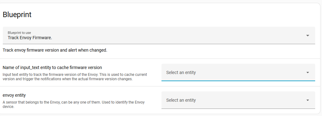

UI view
To add a new input_text entity, use the dropdown and select + create a new text helper.

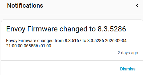

Notification example
