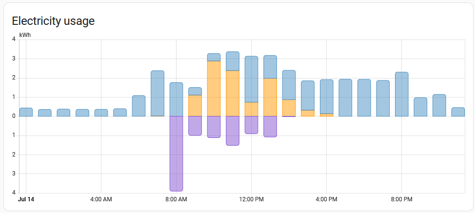

Hi all, following @del13r write up, and it works great… EXCEPT… now I’m getting an 8 AM data anomaly that doesn’t quite make sense.
The return to grid amount is far greater than what is being generated, which isn’t possible. This has happened now for several days in a row.
Here is it looking correct for the first day after setting up @del13r’s custom sensors:

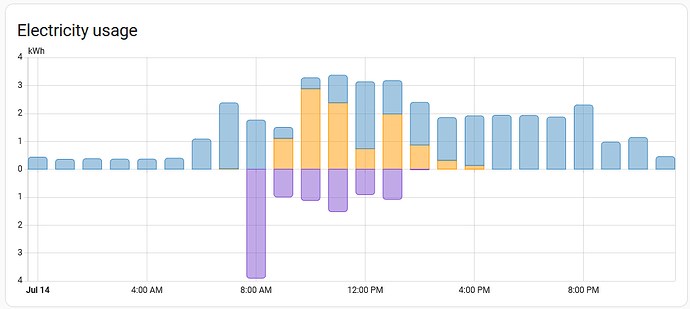

And here is the last 2 days:
Any ideas? Is the Riemann sum integral sensor doing something weird at this time?

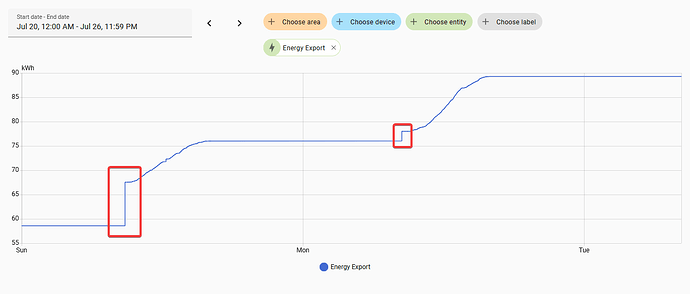

Looks like its got something to do with the export helper:
edit: appears that changing the integration method for the Power Export helper from Right Riemann sum to Left Riemann sum seems to sort this out

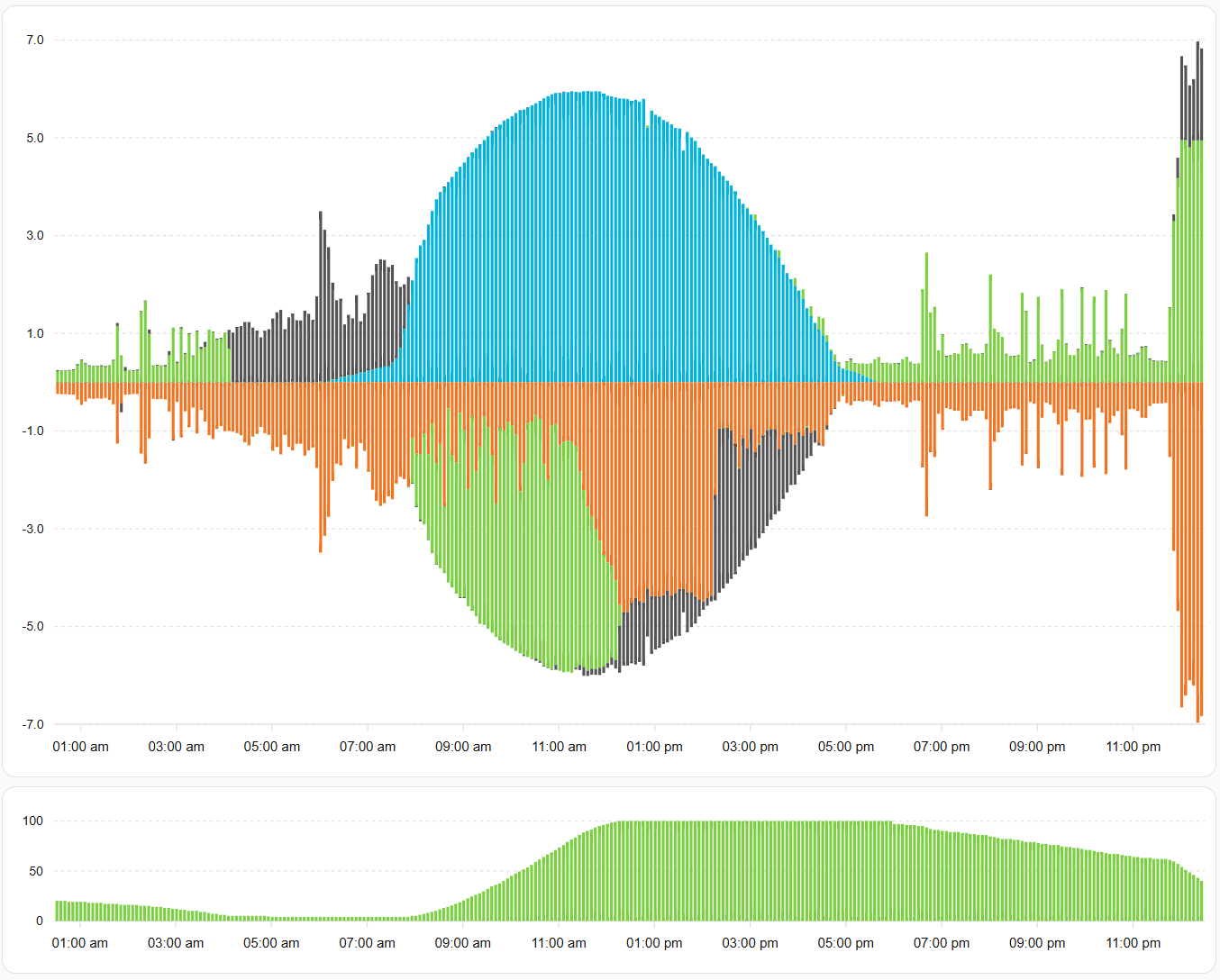

Here is what I have done with my powerwall 2 data to replicate the look and feel of the enphase graphs.
card:
  type: custom:apexcharts-card
  stacked: true
  apex_config:
    legend:
      show: false
    yaxis:
      min: -7
      max: 7
  graph_span: 1d
  span:
    offset: ${offset}
  header:
    show: false
    title: Total Power
  series:
    - entity: sensor.powerwall2_solar_power
      type: column
      color: "#01B4DE"
      group_by:
        func: avg
        duration: 5min
    - entity: sensor.powerwall2_load_power
      transform: return x *-1 ;
      type: column
      color: "#F37320"
      group_by:
        func: avg
        duration: 5min
    - entity: sensor.powerwall2_battery_power
      type: column
      color: "#7BD042"
      group_by:
        func: avg
        duration: 5min
    - entity: sensor.powerwall2_site_power
      type: column
      color: "#545456"
      group_by:
        func: avg
        duration: 5min
