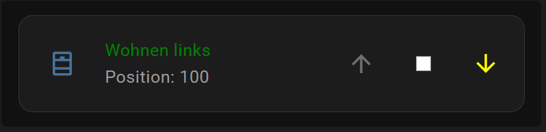

I’m struggling with a cover entity. I’m trying to change the color of the text in the second row and the first arrow (up). child(1) is being ignored. What’s my mistake?
type: entities
entities:
  - entity: cover.wohnzimmer_links
    secondary_info: position
    card_mod:
      style:
        hui-generic-entity-row ha-cover-controls:
            .state ha-icon-button:nth-child(1) {
            color: blue;
            .state ha-icon-button:nth-child(2) {
              color: white;
            .state ha-icon-button:nth-child(3) {
              color: yellow;
          :host {
            color: green;
So, I pasted your code into my test dashboard and updated to one of my covers.
Of course, mine is light instead of dark. But, I get the blue and not the yellow. Grrrr
thanks you! I found the issue. If the cover is in endposition, the color of the arrow is ignored. sorry for confusion.
Don’t be sorry. Glad to help identify the issue!!!
Luckily, mine was closed and yours was open. LOL

Because when the cover is fully open or fully closed, the up or down controls are inactive. Therefore, the icon will have a disabled class, which has a gray color. In your case, the cover is in position 100, so the up button is disabled.
I understand that clicking at 0%/100% should be disabled. But, color change should be changeable in my opinion.
