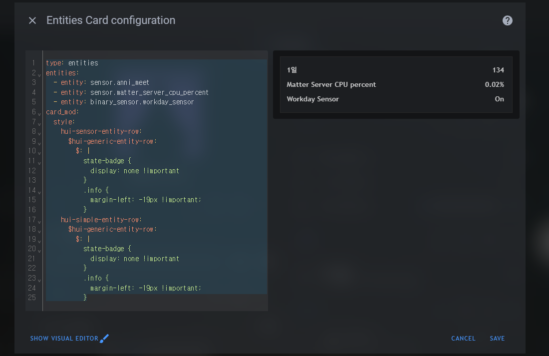

Hello, I know this is an old thread, but I’m posting because I have a question. I want the code to run efficiently. I’m running card-mod 3.4.4 on ha-core 2025.4.3
There are various mixed entity types, such as sensor, binary_sensor, etc.
The following code works.
like this;
type: entities
entities:
  - entity: sensor.anni_meet
  - entity: sensor.matter_server_cpu_percent
  - entity: binary_sensor.workday_sensor
card_mod:
  style:
    hui-sensor-entity-row:
      $hui-generic-entity-row:
          state-badge {
            display: none !important
          .info {
            margin-left: -19px !important;
    hui-simple-entity-row:
          state-badge {
          .info {

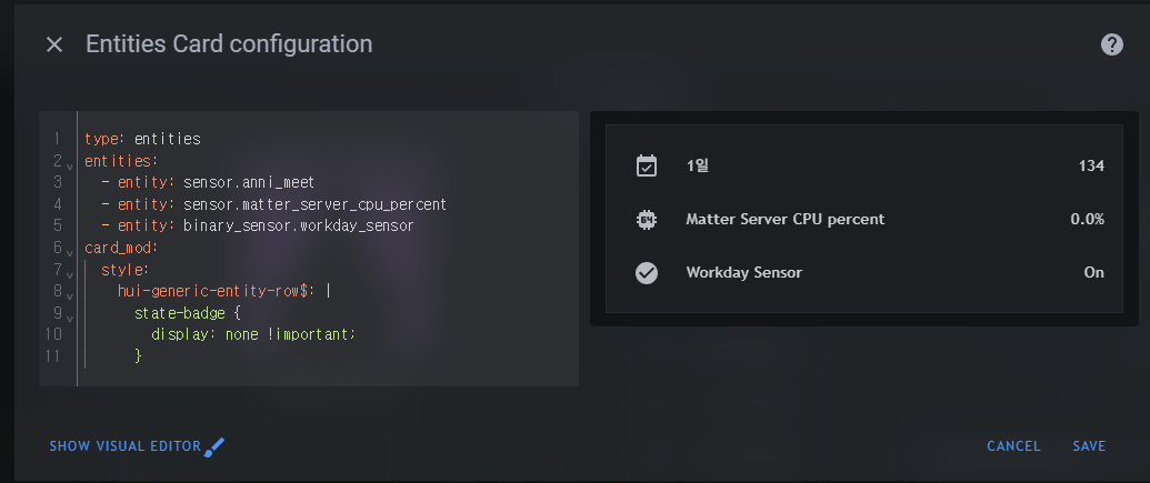

However, the included example code doesn’t work.
type: entities
entities:
card_mod:
  style:
    hui-generic-entity-row$: |
      state-badge {
        display: none !important;
I’m not sure what I’m overlooking. Any help would be appreciated.
Suggest to ask all card-mod related questions in the main card-mod thread.
In short, the 1st code addresses rows form a card’s level; the 2nd code does the same - but it addresses in a wrong way: this way is used when addressing from a row’s level.
Oh, I see. I was simply thinking of hiding the icon.
I understand now from your reply. I was misreading the structure. Thank you.
