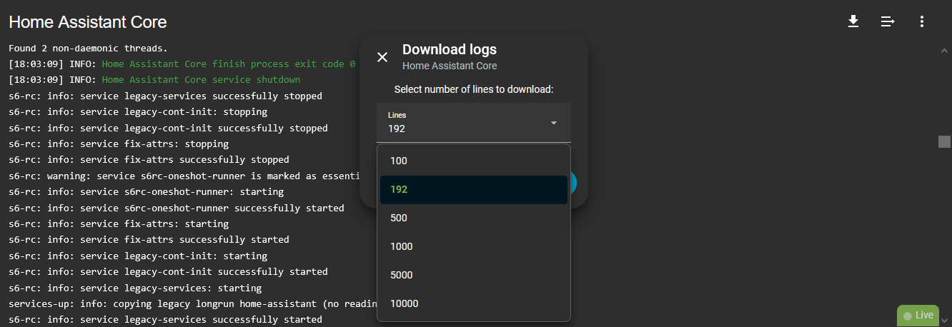

go to /Setting/System/Logs , Click on the 3 dots to the right “Show Raw Logs( reads from journal i believe )” , Then click on the Download Arrow (Choose 10000 Lines) …should cover back to before the 14th-June ( If you’r lucky )
Or check files in /Journald, Logs gets “rotated” not overwritten after a week or 2 ( or a day )
” /var/log/journal/xxxxxxxxx/bunchoffiles”
Earliest Log from ha settings is from 2026-06-15 23:16:41.497.
/var/log/ is empty in the lscr.io/linuxserver/homeassistant docker container i use
as i said, im not into Docker, but im pretty sure HA uses Journald even in a Docker-Install ( I could be wrong ) ( Maybe you are looking in the wrong Container )
Did You download 10000Lines ?, in that case you have serious issues
/Settings/system/Logs 3 Dots to the Right, RAW-Logs
Download Arrow ( Beside(infront) of 3 Dots ) Choose 10000
If this wont work for you, i believe you have to use a “Linux Journal Reader” to read the individual logfiles ( Or linux command-line ), And read HA Docker-Install Docs( for the location of rotated logs ), If that’s your HA Install Type
Yes, downloaded all the lines and the file starts at 2026-06-15 23:16:41.497, then i scolled to the top with the earliest log being the same.
