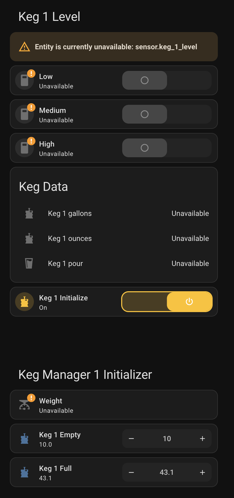

Anyone having an issue with the latest update with Home Assistant? I updated and suddenly a couple of enitites are no longer available. :confused:
like what entities ?

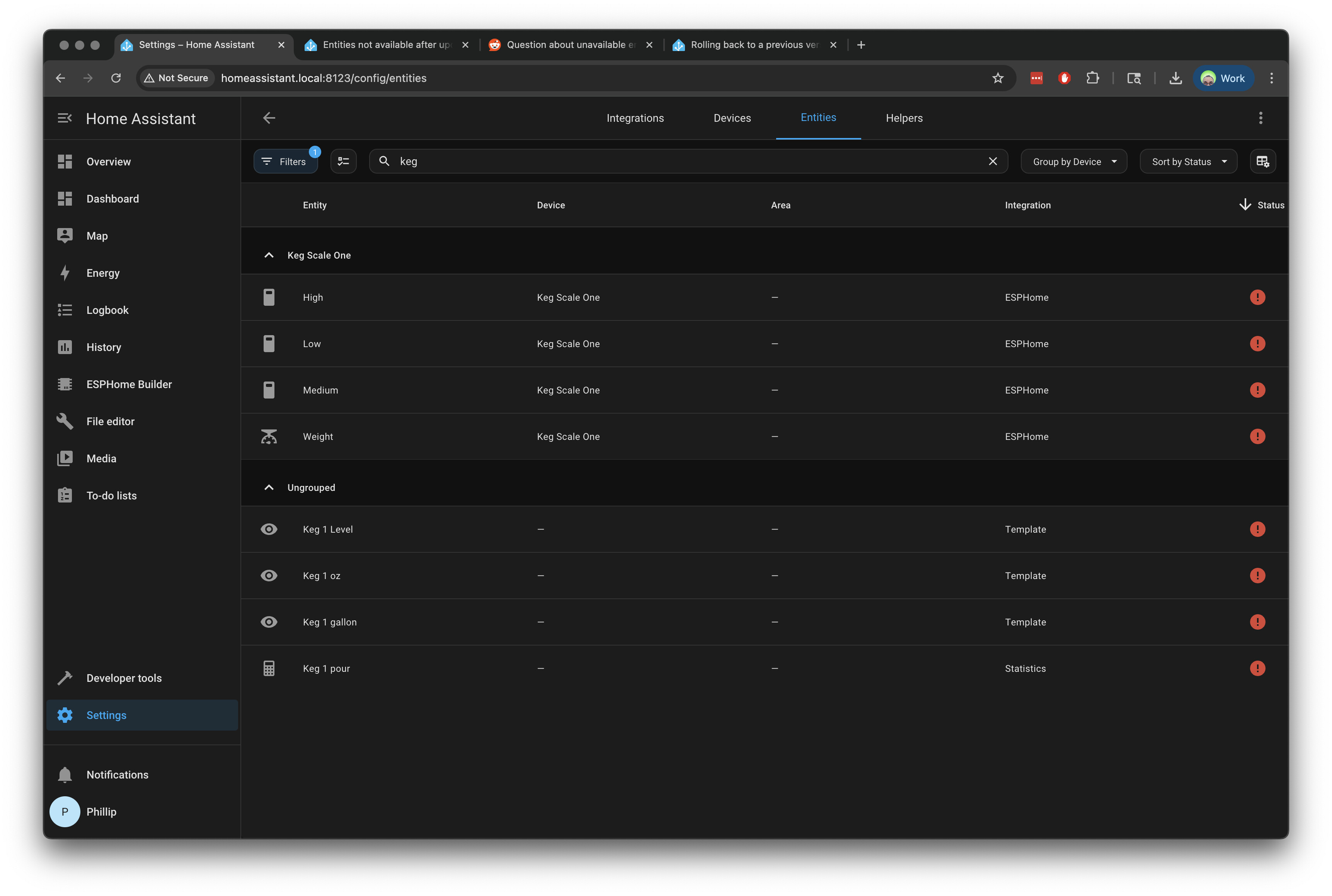

Not sure what happened here?! It was working perfectly before the update.

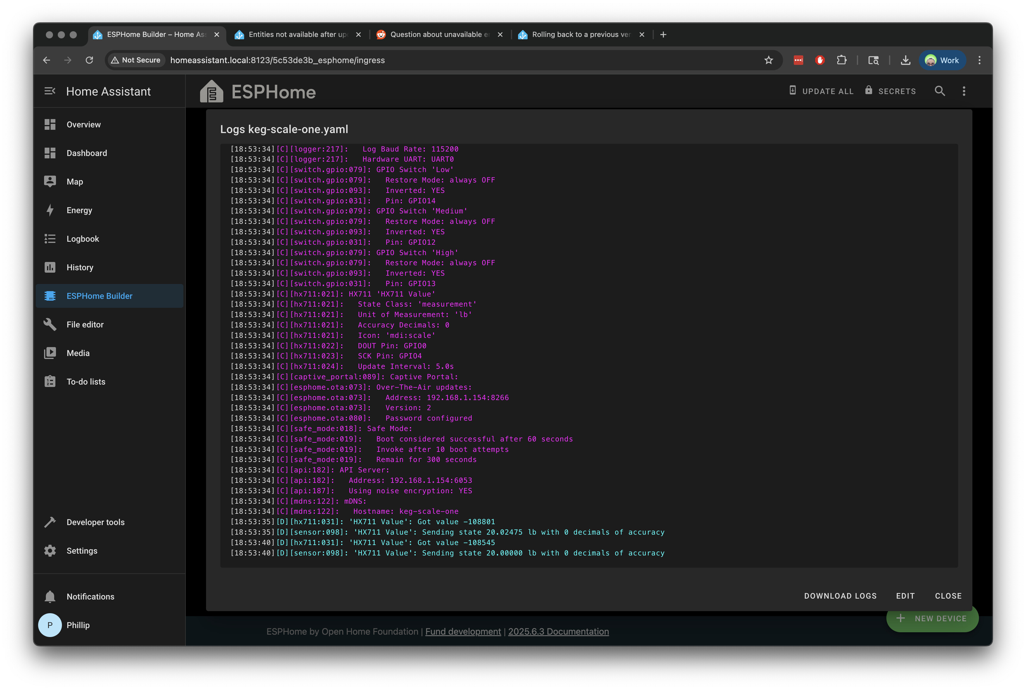

is your esphome avalible ?
try to log your esphome device with esphome builder
It’s logging weight so it’s working there…
I put a 20lb test weight on it.

in some point did you change the entity name?
Not that I recall.

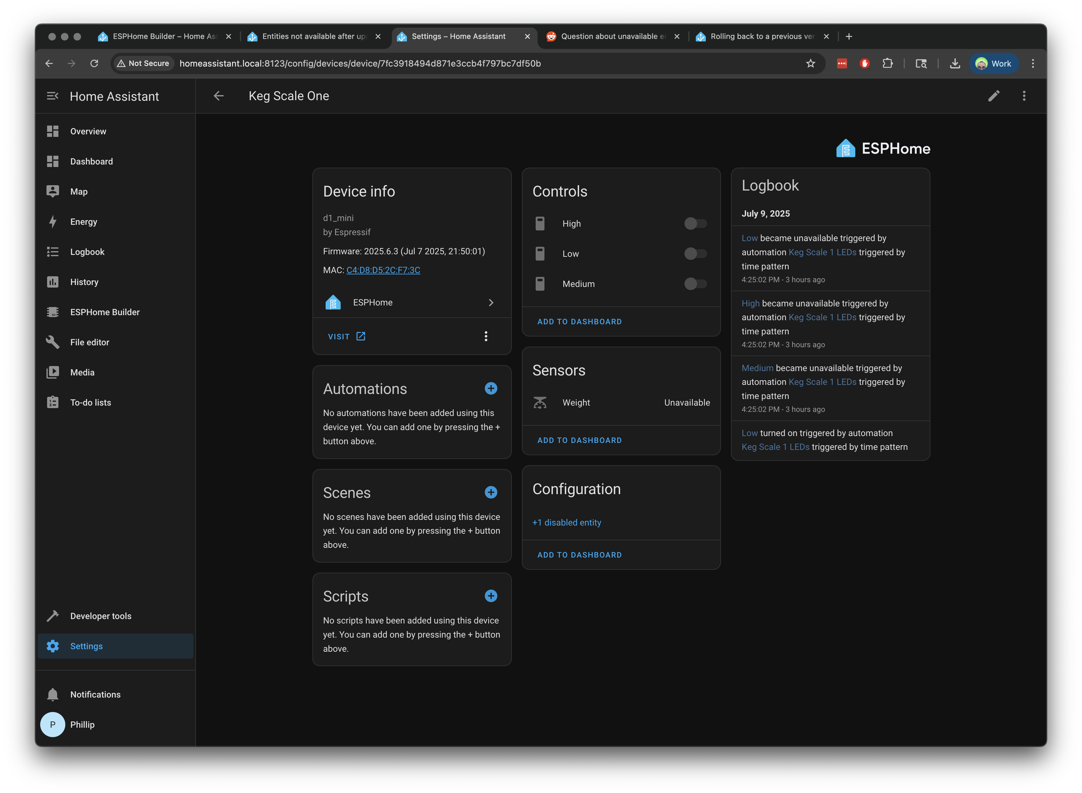

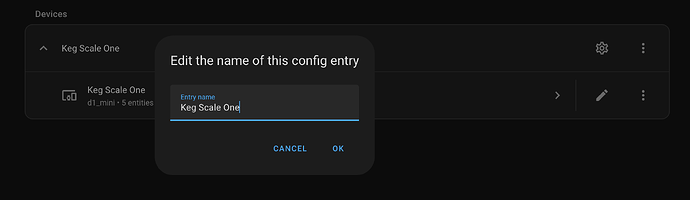

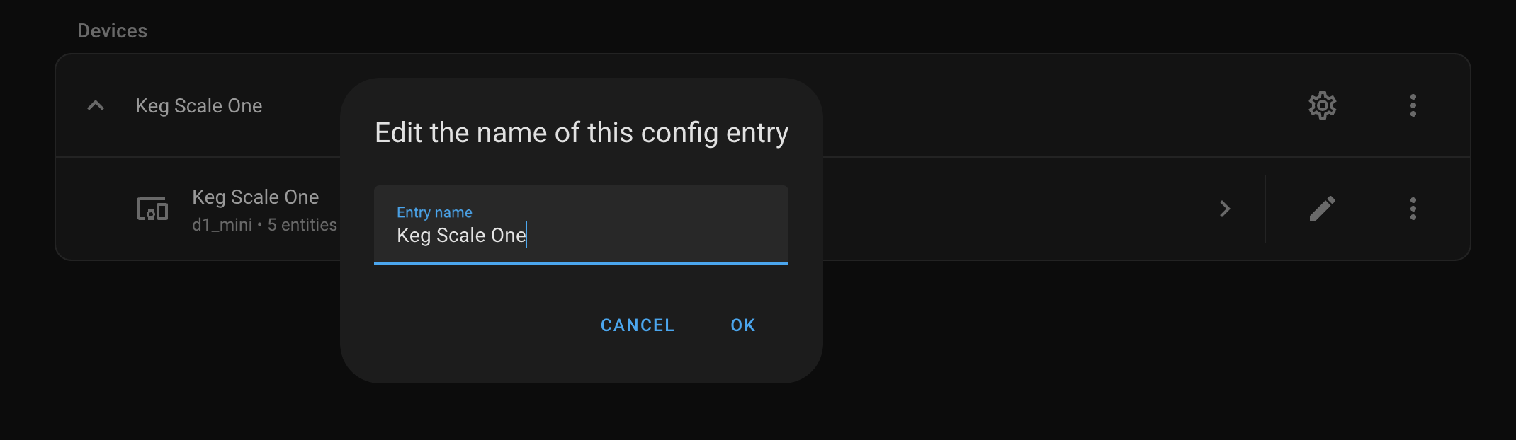

Should this be ā€œkeg-scale-oneā€ instead of ā€œKeg Scale Oneā€?

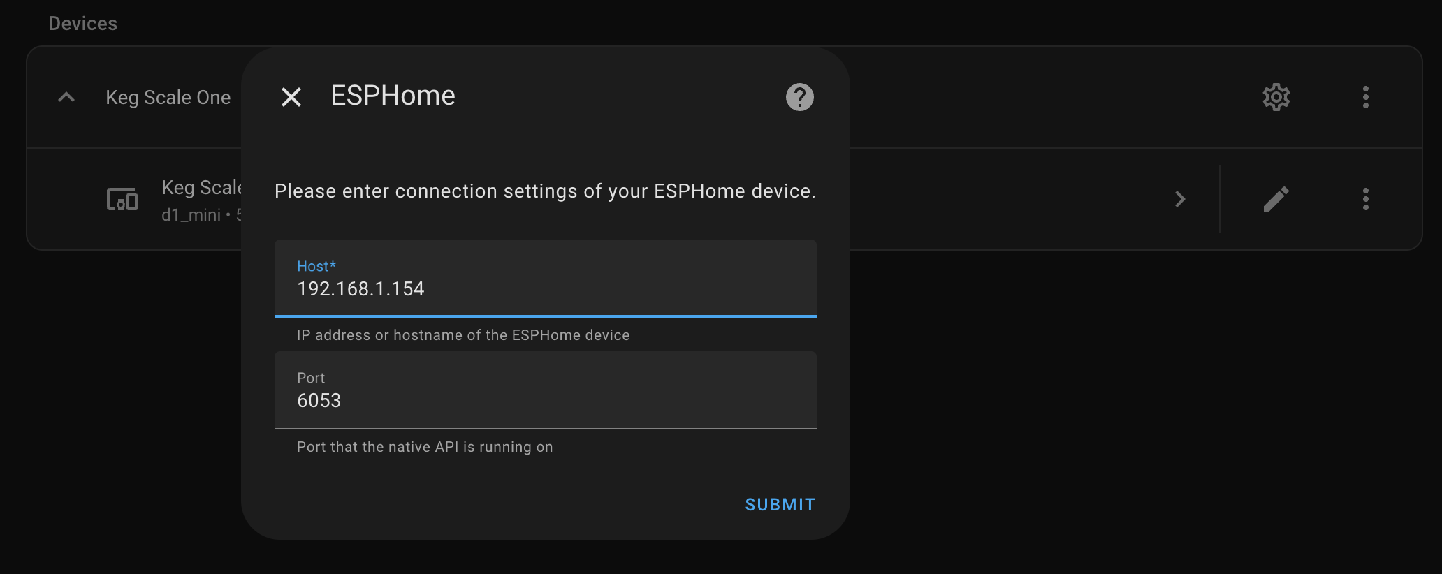

what happend if you access you device , dont change the name just go inside
like this
Looks like this…
ok delete the device and it will be auto discover again
if is not auto discover add it manually with the ip from the log i believe it was 192.168.1.154

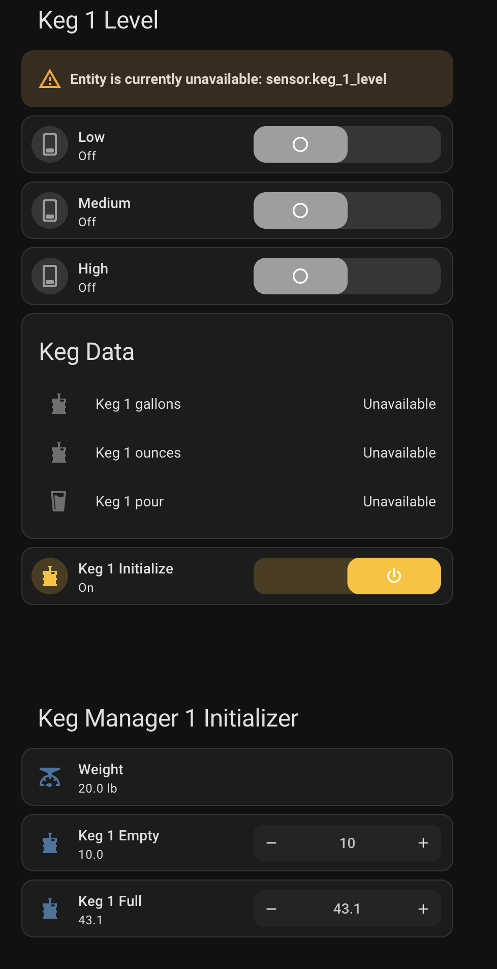

All but the Keg Level are working now.

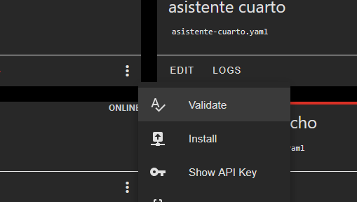

on esphome builder validate your device to check if the upgrade cause something

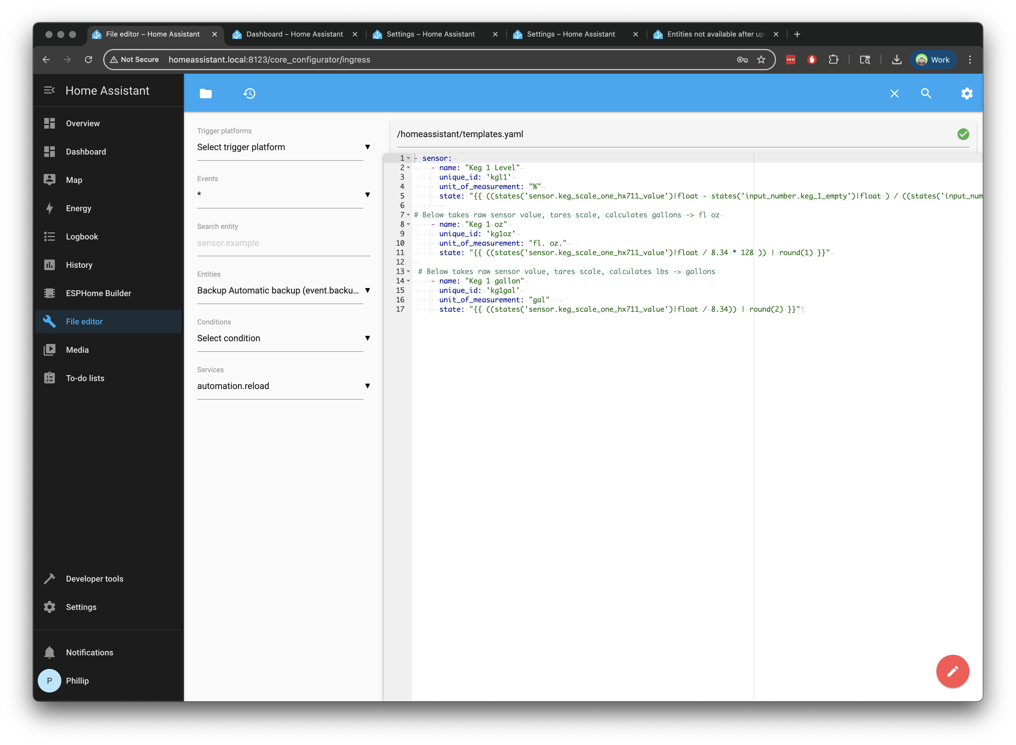

It validates fine. My template.yaml file looks like this…

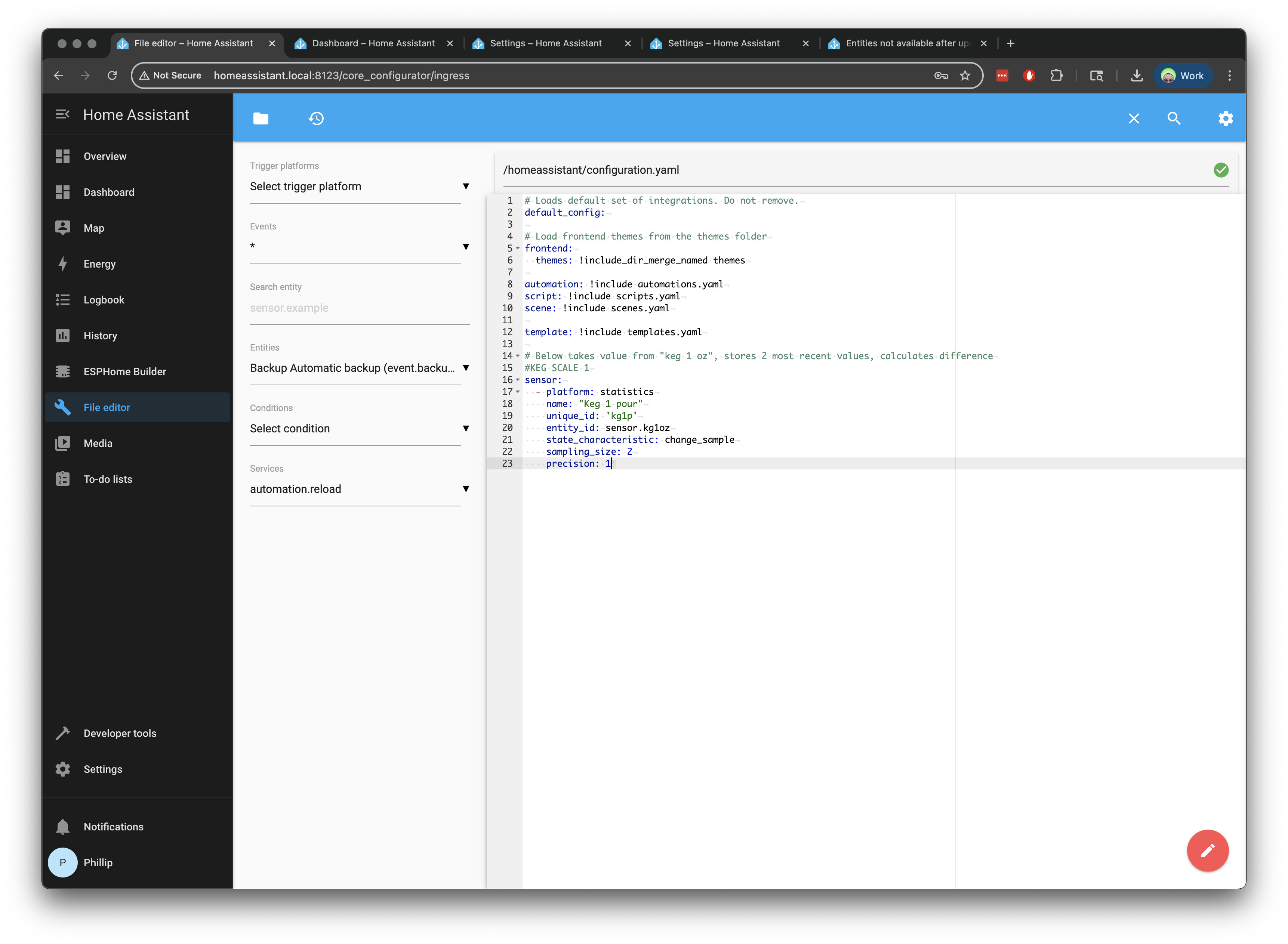

That seems to validate fine as well. My config file looks like this…
Typically in web coding like php a !include would mean not to include that file not sure if the same holds true in yaml though and I didn’t edit this file it was working fine pior to the update.

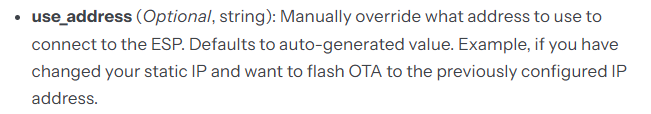

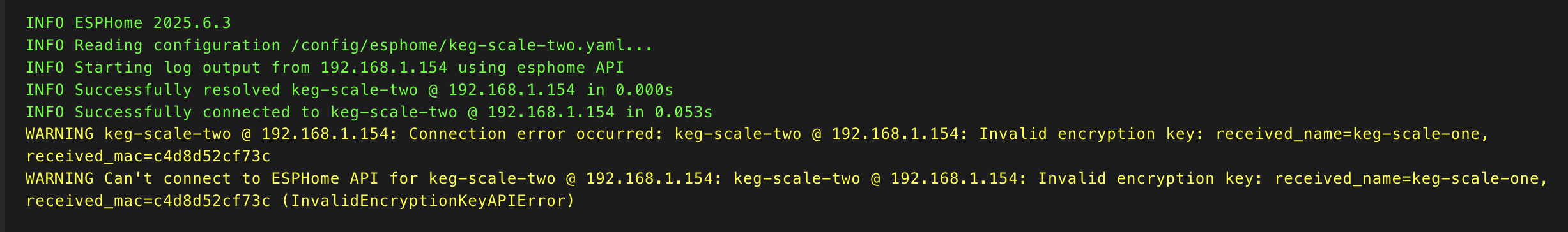

Here’s a question; would the ip address of a similar device be different? I’m trying to setup another scale and I’m getting this error on logs…
Core or OS update?
And ā€œlatestā€ isn’t a version. Please be specific and provide the version number.
Each device has to have a unique IP address. If you copied the config and did not change this then you are going to have a bad time. You will need to do use the ā€œuse_addressā€ option to correct this.
https://esphome.io/components/wifi.html#configuration-variables
