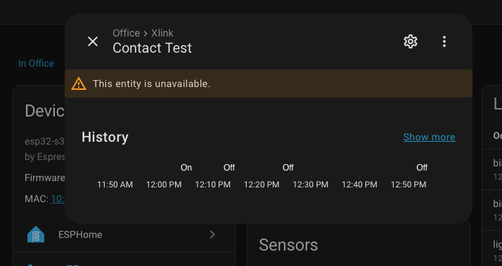

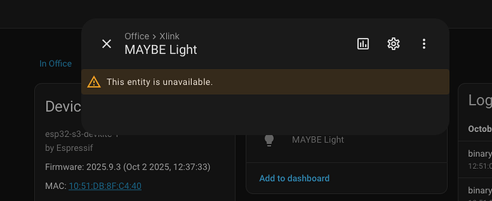

So I’ve been trying to get up and running with ESPHome. Generally seems to run really smoothly, No trouble flashing devices, no trouble adding them to HA. However, once added to HA, the entities are always ‘unavailable’.
I’ve basically been trying a super basic device. One LED set up as a light I can try to turn on or off and one binary sensor. When I go to the Device Info screen, I can see the light I set up and the sensor, but if I click on either one, the window just says, “This entity is unavailable.” That’s it. Nothing to click on or anything.

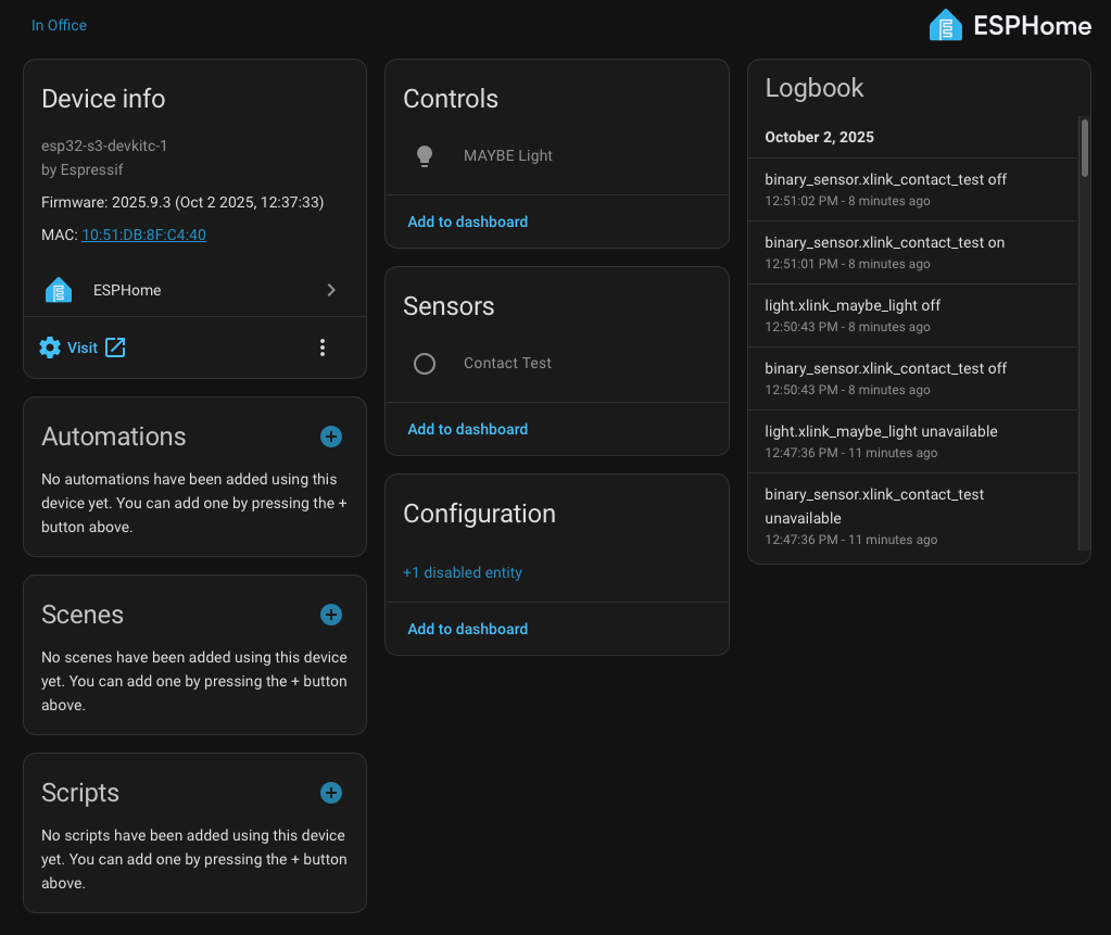

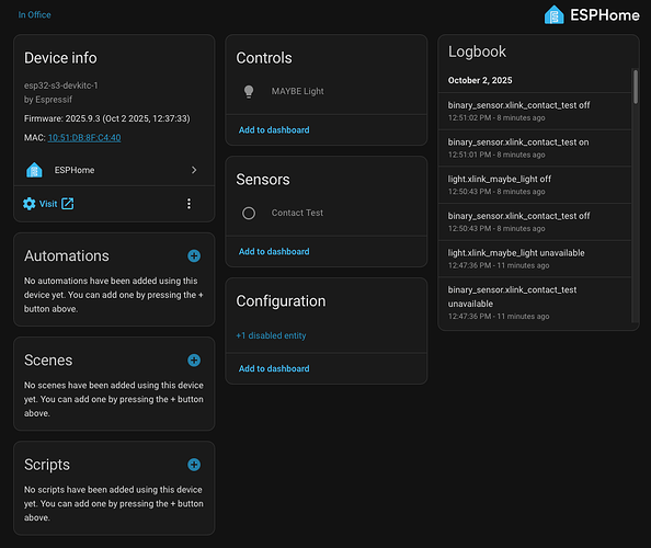

I’ve searched and have seen some people with this problem and the recommended solution seems to be “delete and re-add”. I have tried this several times (along with other iterations like, Delete Device, Restart HA, then Re-add). Same result every time. I have tried 3 different ESP32 boards, and one ESP8266. I’ve currently got it activated via a Waveshare ESP32-S3 with Ethernet port (Connected via ethernet). Both the light and the sensor are still unavailable, BUT, if I close the circuit on the sensor, the Logbook panel on the right side of the Device Info screen reports the sensor turning on or off. So HA definitely can communicate with this thing, but I just don’t know how to make these entities ‘available’.
Attaching yaml for the device and a couple of screenshots. Appreciate any help or insights anyone may have.

By saying the sensor worked, I basically have a jumper on the breadboard so I can ground pin 3 (like the most rudimentary kind of sensor - just trying to get a basic ESPHome device working). So I connect the jumper to ground, and the logs would show the sensor going ‘on’. Also in the Device Info window (top right of first screenshot), even though the entity was unavailable.
Regardless, I got fed up and had to run some errands with my wife. Checked HA from my phone while I was out… and the entities were available. I’m home now and sure enough, I can turn the light on the breadboard on and off from HA. I didn’t do anything to change this. It just seems to work now.
