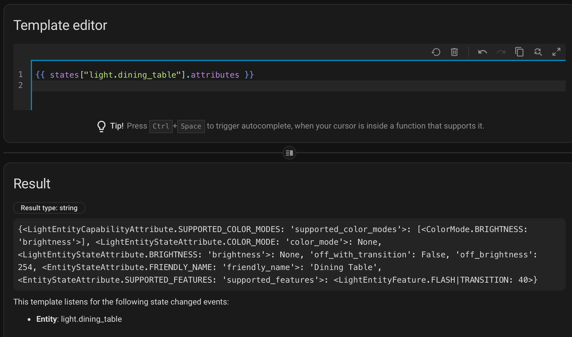

Trying to debug a blueprint which broke during the summer, and have tracked it down to some kind of change in how the entity attributes object works.
It seems the dictionary keys for the attributes object are no longer plain strings, but something else? You can still access individual values as if the keys were strings, but serializing an attributes object (or an object derived from an attributes object) does not work. Passing it back from Jinja to HA, the keys are weird so HA can no longer re-interpret the returned string as a dictionary.
Why did this change and how do I work around it? Is there some way to convert all dictionary keys for an object into plain strings?!

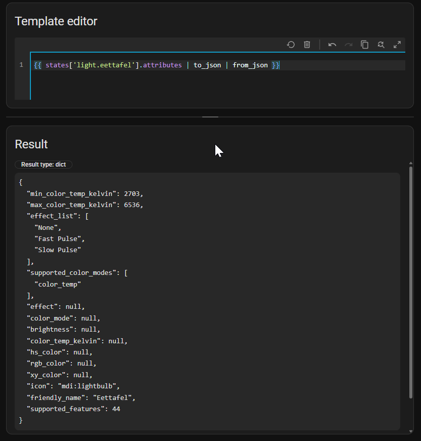

Easiest to work around this, is a conversion to json string, and back to a dict.
What you are seeing is that attribute keys can now be enum values instead if strings. As json doesn’t support that, the values are converted to string by to_json

Thank you, that does explain and solve the problem!
