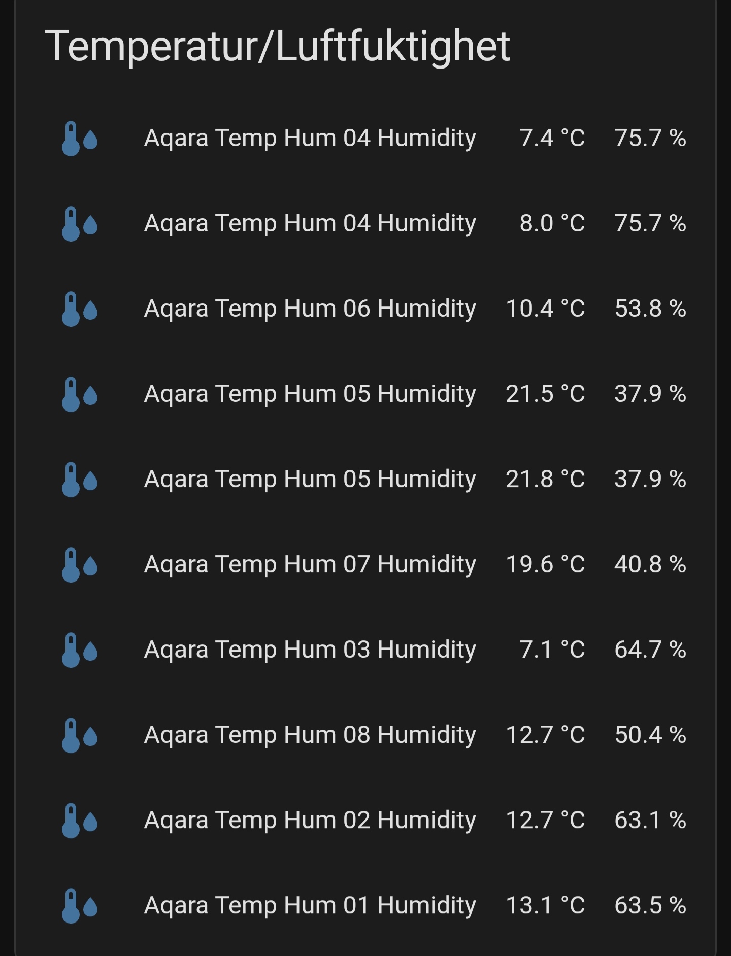

Entity labels not always showing in the app?
Am I the only one with this issue?
It only happens in the app and is usually fixed by restarting the app. A bit annoying though.
You're not the only one, and the good news is it's not your config or your sensors. The tell is what you said: app-only, and fixed by restarting the app. A real data/registry problem (genuine duplicate entities, wrong sensor mapping) would show up everywhere including a desktop browser, and wouldn't clear on an app restart. App-only and transient = a rendering glitch in the Companion app's WebView, not bad data.
What you're seeing is classic virtual-list row recycling: long entity lists are drawn with a recycled set of row elements, and when scrolling/refresh goes wrong the labels and values get mismatched and rows duplicate. That's why rows named "…Humidity" show a temperature as the primary value, and why 04 and 05 appear twice. The underlying states in HA are correct, only the on-screen pairing is scrambled. Quick proof: open the same dashboard in a normal browser and it'll be fine.
Alright, can something be done about it? They are actually not duliicated though, I use the same value for some because irs different sensors, not all hsve a humidity.
Right, if these are genuinely separate sensors and not registry duplicates, then nothing's wrong with your data, this is purely the name/label not rendering in the app. That's a Companion app (WebView) display glitch rather than a Home Assistant problem, which is why a restart clears it.
