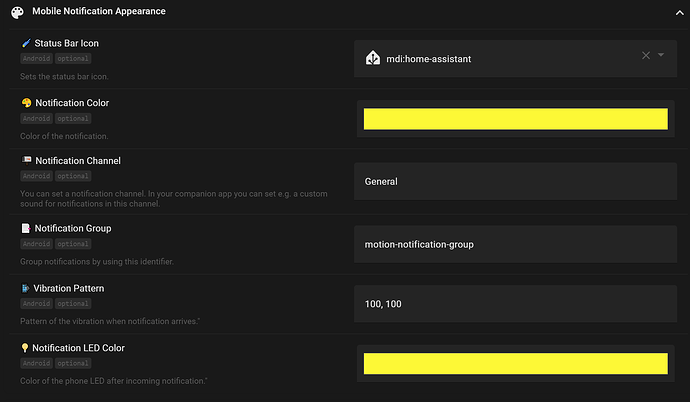

You’ll find an option for enabling auto close now in the notification settings section.

Thanks for the blueprint @panhans, one question on changing something. Is there a way to keep the notification from disappearing on my phone (IOS) after the state changes back. Here is my use case. I want to be notified if a door opens when I am away. The notification works great, but the problem is that the notification disappears as soon as the door is closed. I don’t always see it in time, and would like to have it stay on my phone until I dismiss it. Thank you.

Already there:
