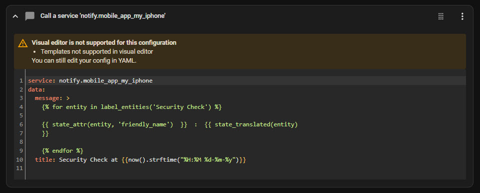

I did. I labeled the entities I wanted with “Security Check”. Then used your code with minor edits for my use in the actions sections for call service.
service: notify.mobile_app_my_iphone
message: >
{% for entity in label_entities(‘Security Check’) %}
{{ state_attr(entity, 'friendly_name')  }}  :  {{ state_translated(entity)
{% endfor %}
title: Security Check at {{now().strftime(“%H:%M %d-%m-%y”)}}
(sorry not sure how to format the code section properly… but it looks like below.)
I also found using state_translated gave me the friendly state of the entity instead of the generic state. IE door contacts show as open/closed instead of on/off.
Your example got me going in the right direction. Thank you.
