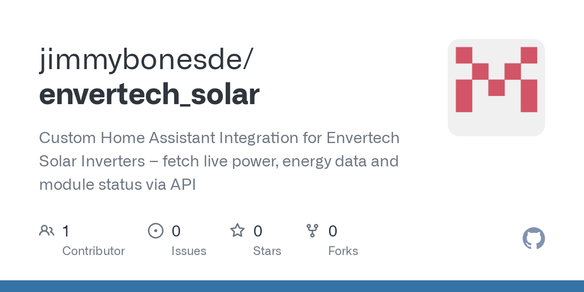

I’m thrilled to introduce my custom integration for Home Assistant that seamlessly connects your Envertech ECO/SE solar inverter to your smart home. This addon fetches live data directly from the Envertech Solar Portal, giving you up-to-the-minute insights into your solar power generation and energy usage.
Key Features:
Live monitoring of current solar power (in watts) and energy totals (daily, monthly, yearly, and lifetime in kWh).
Full compatibility with Home Assistant’s Energy Dashboard — perfect for anyone wanting detailed solar analytics.
Simple setup through HACS or Home Assistant’s integration menu with your station ID.
Automatic updates every 30 seconds to keep your data fresh and accurate.
Why choose this integration?
Native sensors designed to work flawlessly within Home Assistant’s ecosystem.
Clean, reliable, and optimized for real-time solar monitoring.
Open source and actively maintained — your feedback and contributions are welcome!
Ready to get started?
Explore the integration, detailed installation instructions, and support here:
