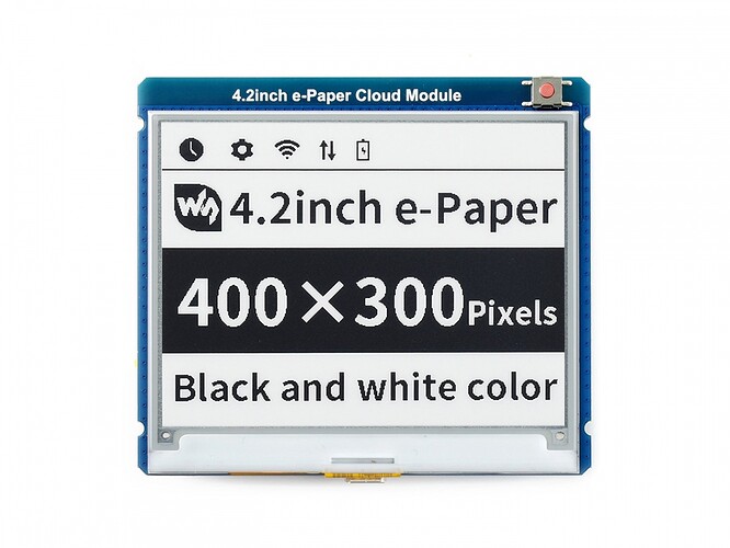

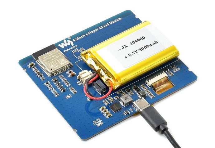

I got an ePaper from Waveshare, 4.2 inch, called Cloud Module as it is delivered with an embedded ESP32 module (Expressif WROOM-32), providing BT and WLAN connectivity. It is sold under the SKU 18525.
I have configured it with the given App and it is visible in my network. It comes with some python functions from Waveshare that can be used to configure it.
I was able to put on text and images using such python scripts from an RPi I have in the network.
The problem is that these functions require extra python libs not available under HA.
