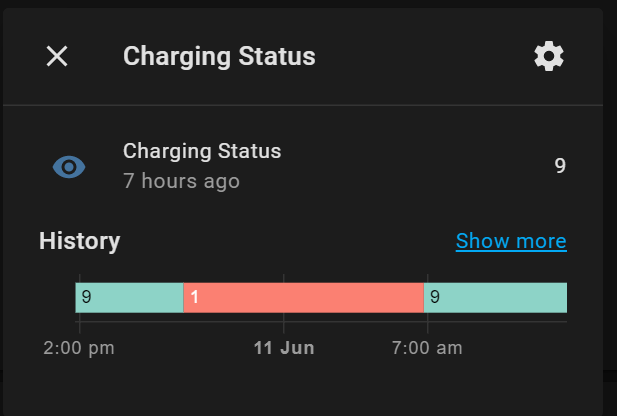

Has anyone successfully implemented address 12800 - 12803? As per documentation, each can have multiple values. I want to see the same values as the screenshot below provided by epever.
- name: PV Battery Status #0x003200
hub: epever
slave: 1
register: 12800
register_type: input
scale: 1
precision: 0
#D15: 1-Wrong identification for rated voltage
#D8: Battery inner resistance, abnormal 1, normal 0
#D7-D4: 00H Normal, 01H Over, Temp.(Higher than the warning settings) 02H Low Temp.(Lower than the warning settings),
#D3-D0: 00H Normal ,01H Over Voltage. , 02H Under Voltage, 03H Over discharge, 04H Fault
#Status analysis
#Array status:address 3201 bits D15-D10
#Charging status:address 3201 bits D3-D2
#Battery status: address 3200 bits D7-D0
#Load status: address 3201 bits D9-D7,
#Device status: address 3200 bit D15 address 3202 bits D13-D8,D6-D4 address 3201 bits D6 address 2000
- name: PV Charging Equipment Status #0x003201
hub: epever
slave: 1
register: 12801
scale: 1
precision: 0
#D15-D14: Input voltage status. 00H normal, 01H No input power connected, 02H Higher input voltage , 03H Input voltage error.
#D13: Charging MOSFET is short circuit.
#D12: Charging or Anti-reverse MOSFET is open circuit.
#D11: Anti-reverse MOSFET is short circuit.
#D10: Input is over current.
#D9: The load is over current.
#D8: The load is short circuit.
#D7: Load MOSFET is short circuit.
#D6:Disequilibrium in three circuits.A17
#D4: PV input is short circuit.
#D3-D2: Charging status. 00H No charging,01H Float,02H Boost, 03H Equalization.
#D1: 0 Normal, 1 Fault.
#D0: 1 Running, 0 Standby.
#Status analysis
This is what I am getting and not sure how to interprete
and
