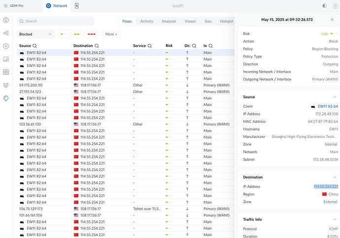

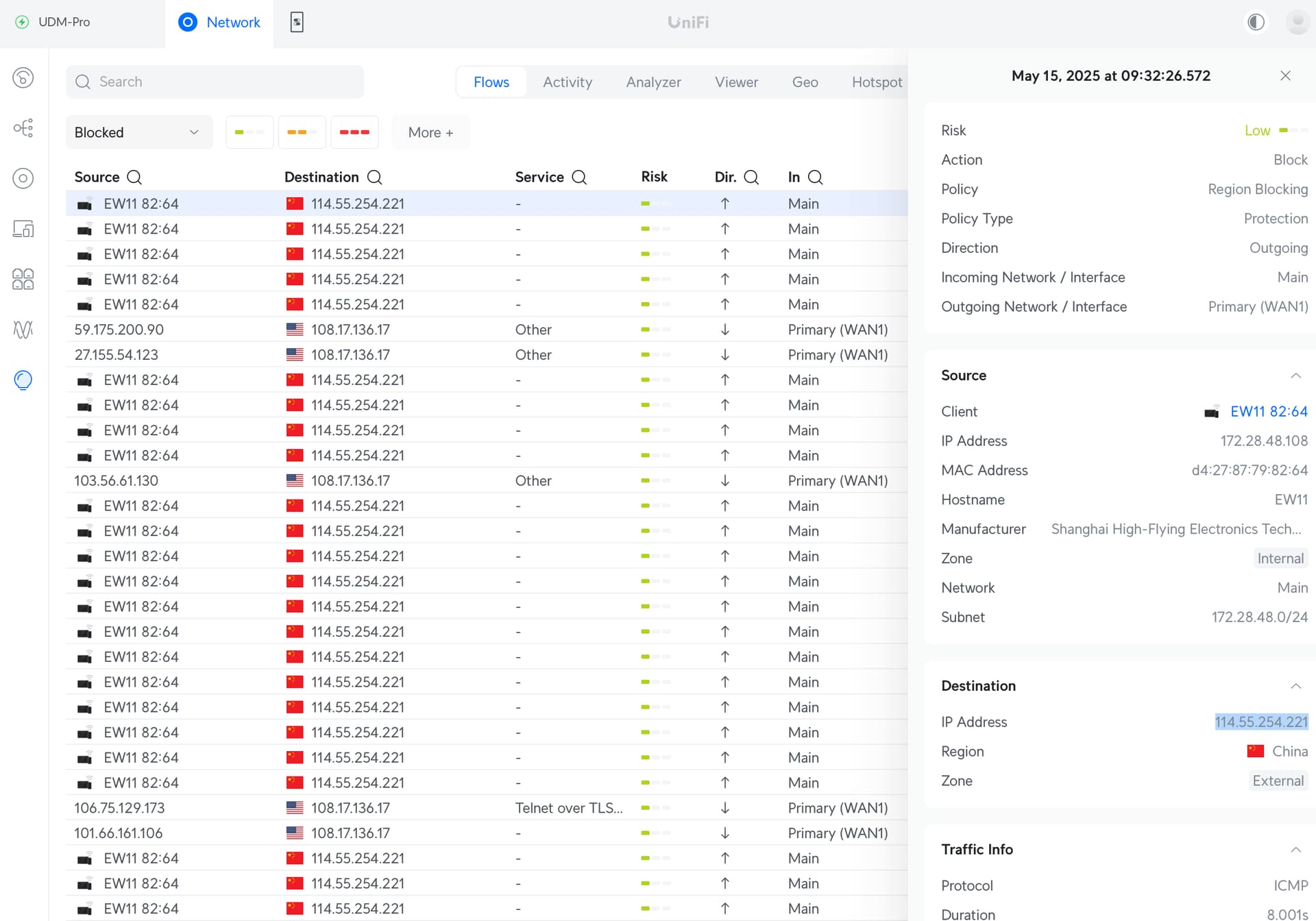

Strange!
The Elfin is very robust but since a couple of days it trys to connect to china :open_mouth:
Mine is doing the same thing.
Is there any way to make it not try to connect to China every minute?
It looks like ICMP.
