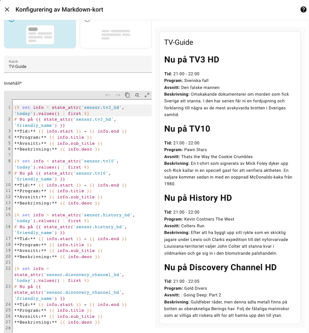

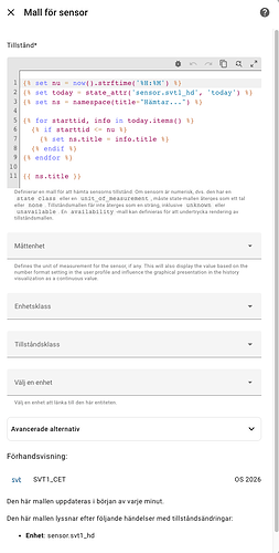

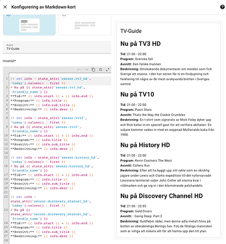

For me the HA-EPG works perfectly. I really don´t use the epg-card, i use a Markdown-card. I also create helper and make Template-sensors with adjusted time for my country (Sweden).
I miss some color, textsize, background-plate, color, transparency options in the epg-card. But i really use the integration every day, i have automations send me notifications when a specific program starts. Every day i get a notification with a list of my favourites fo the evening, when stay start and description.
Thank you yohaybn for your good work, this is a really a good start. I have been looking for a long time for a integration for TV-Channels.
