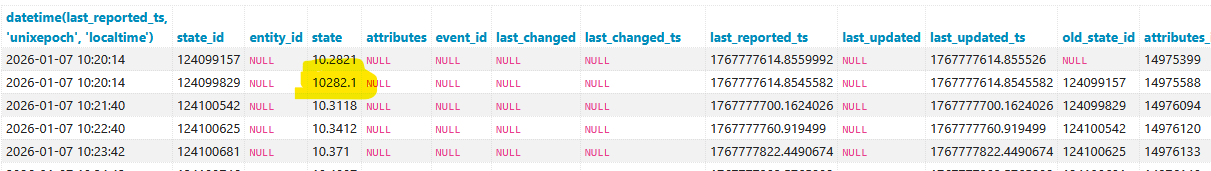

This is one example from the states table for that sensor:
As this happened several times during the last ~10 days and it skews the stats quite a lot, I’d like to fix this AND not have it happen again.

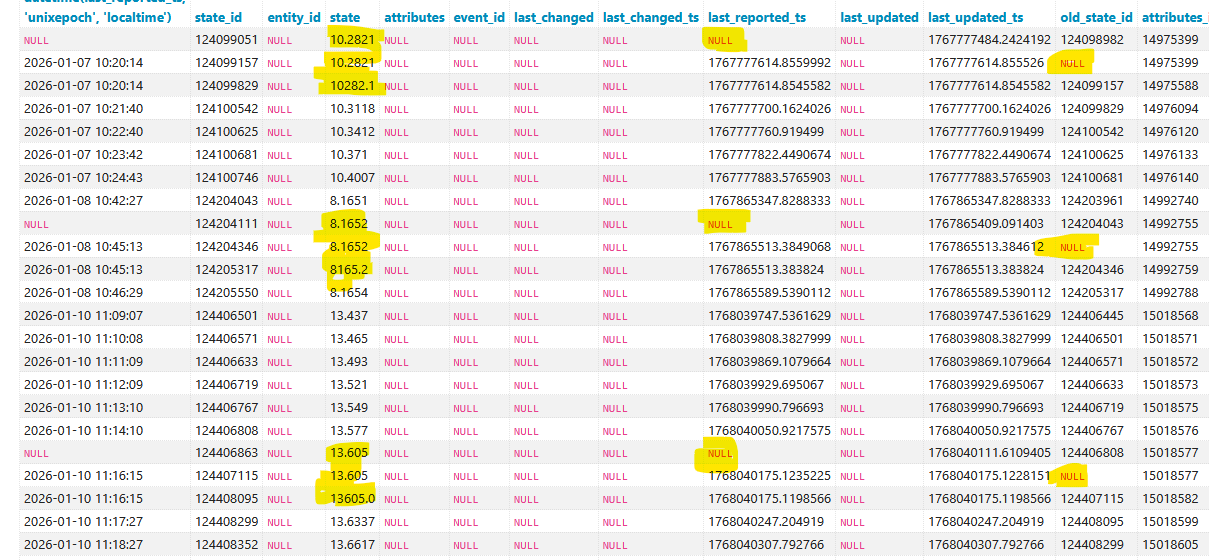

Next: preventing. I have no idea how or why this happens, but there is always a state with “last_reported_ts” and one with “old_state_id” NULL quite near to that bogous value, see excerpt here:
I would now guess that this could be somehow connected to HA restarts…?

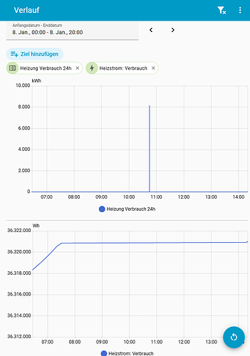

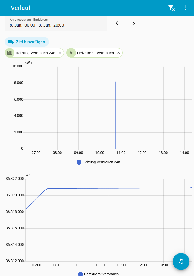

Show the history graph of this sensor when the spikes occured:
sensor.heizstrom_positive_active_energy_total
Use the history panel, not the pop-up info card (it shows 5 minute statistics not states).
Here you go:
(Just one of the instances)
That’s two graphs, which one is it?
Top one is the 24h aggregate (the utility meter graph), the lower one is the base energy consumption sensor ( sensor.heizstrom_positive_active_energy_total). Sorry I overlooked that you requested only the latter one :man_facepalming:
