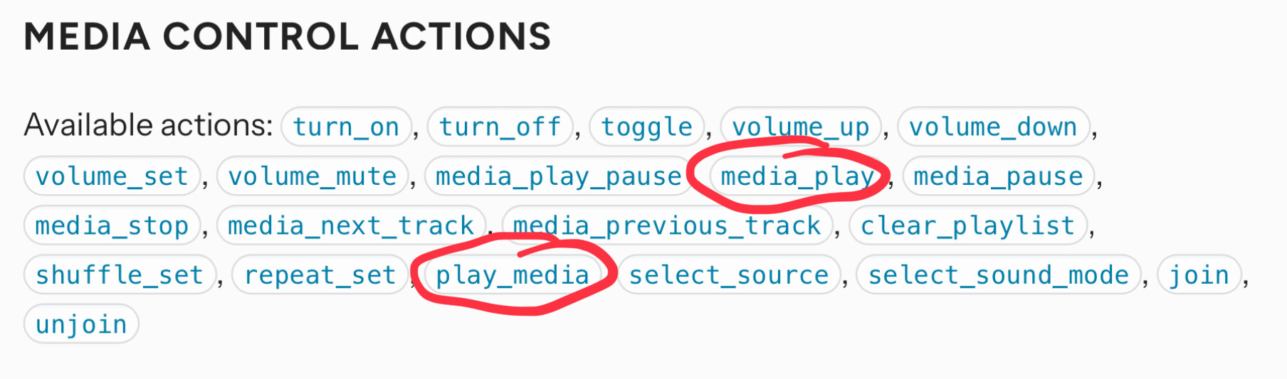

The docs use media_player.media_play and media_player.play_media in different places, maybe it should be play_media?
Only play_media is documented below.
I just tried the automation editor. That accepts both, but only play_media has data parameters. The other one is maybe just play (as opposed to pause)
Yes I think that’s it - thanks. TBH I don’t understand the difference between media_play and play_media. I find it quite confusing!

The play_media action plays some sort of media like a song or video that you specify.
The media_play action is the same as pressing the play button on your media player. If there isn’t something there ready to play then nothing happens. Other actions similar to this are media_stop and media_pause.

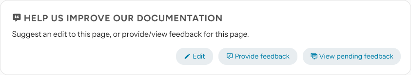

If you feel they could be renamed to avoid confusion or an explanation added to the documentation then use the feedback button (located at the bottom of every documentation page):
https://www.home-assistant.io/integrations/media_player/
In hindsight the latter would probably be better understood if they were called playback_play, playback_stop and playback_pause or just plain play pause and stop. But it is not something I would want to introduce a breaking change for.
