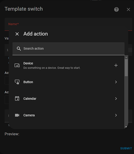

I am getting the same error just now … first i thought it was something that had happened due to the specific sensors but after some restarts and testing a bit I am now getting it for another sensor and did a search and found your post.
as an aside, I thought it was strange(?) it did not allow me to enter an entity.

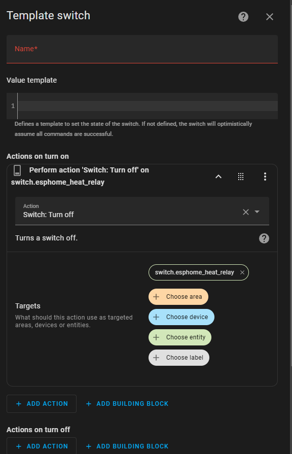

my fix (instead of going full config.yaml) was that I had to go into it as a button (or something else probably would work )… but then go into edit yaml … and put in the code like it should be, for me kind of like this:
action: switch.turn_off
  entity_id: switch.esphome_heat_relay
putting on/off and your sensor in as appropriate :slight_smile:

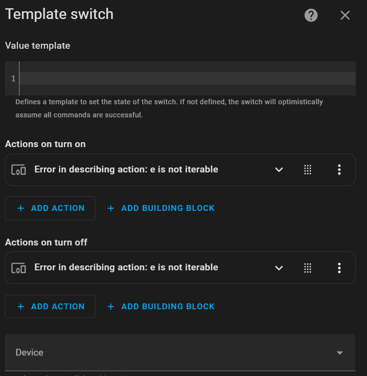

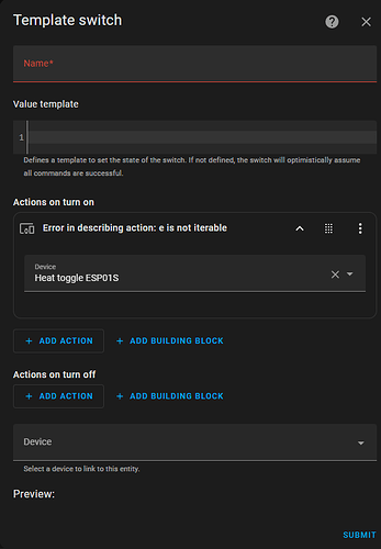

interesting, maybe I am misunderstanding but I honestly had no option to add an entity in the drop down, and had to enter a device which did not work:
i did not add anything but the device and got the error:

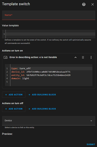

and the yaml that comes up when I hit edit (this is what is the issue I think ?) :
then when putting in my yaml above instead … and going back to visual i get this:
and could proceed.

edit added… so I actually went into this and changed the template and it started to not work… so I went into the sensor and when hitting the switch i could see the error that the dictionary for data was invalid… I thought i was careful not to go near the actions but it anyway when I opened the yaml it had added into both :
data: {}
and the only way i could fix it I found was to remove both actions, submit and update. then go back in and follow the procedure to first add a button and then change the yaml to what i clipped above. Either I am doing something really wrong or this function is really buggy or maybe a bit of both :slight_smile:
