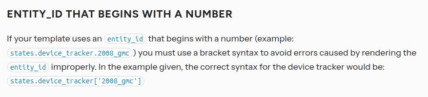

its likely because the entity_id starts with a number. here are the docs that explain what to do to make it work. see the note about half way down:

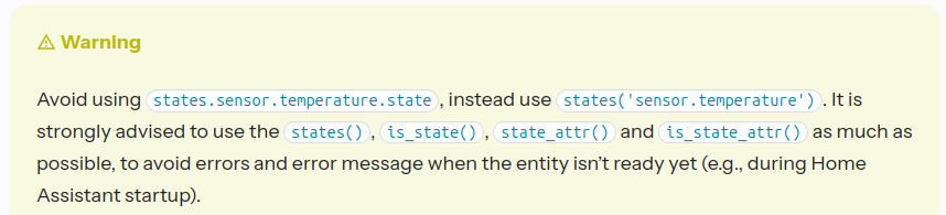

From the Templating documentation:
From the same documentation:
