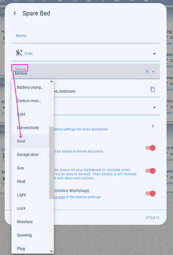

Click on the entity in your dashboard. Select the cog icon in the top corner of the pop-up card.
Then choose “Door” in the “Show As” section.
For future reference other options are shown here: https://www.home-assistant.io/integrations/binary_sensor/#device-class
No templates needed.
