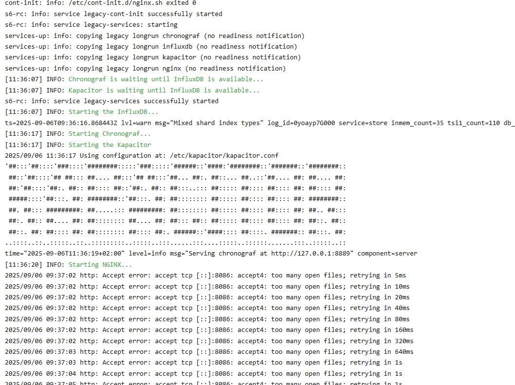

Error InfluxDB Accept error: accept tcp [::]:8086: accept4: too many open files; retrying in 1s
Hey
I just wanted to check something in Grafana and by that found out that my influxdb addon (addon in HA) is not working anymore.
No real clue when this started … .but at least a few weeks back it was working fine
Error says: Accept error: accept tcp [::]:8086: accept4: too many open files; retrying in 1s
2025/09/06 09:39:03 http: Accept error: accept tcp [::]:8086: accept4: too many open files; retrying in 1s
any tip what I could try is much appreciated
Thanks
