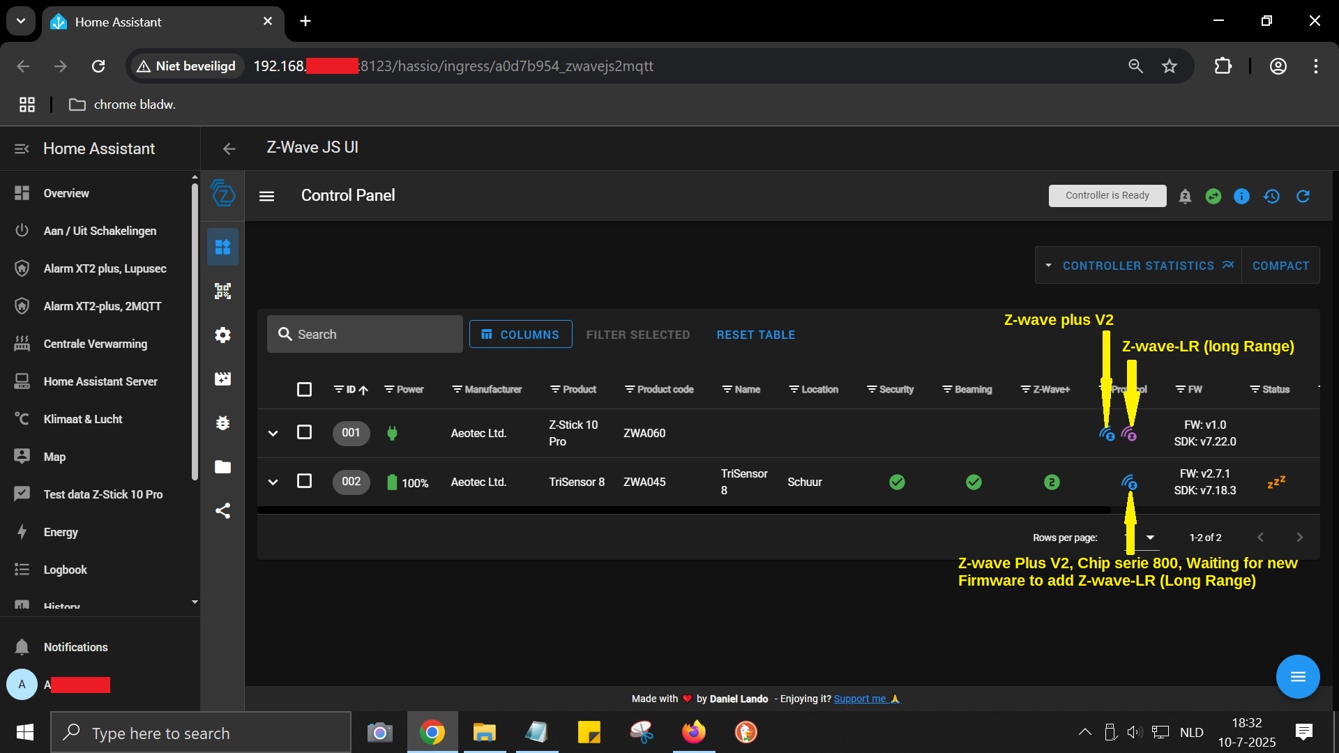

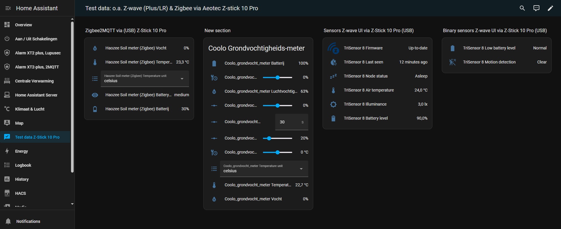

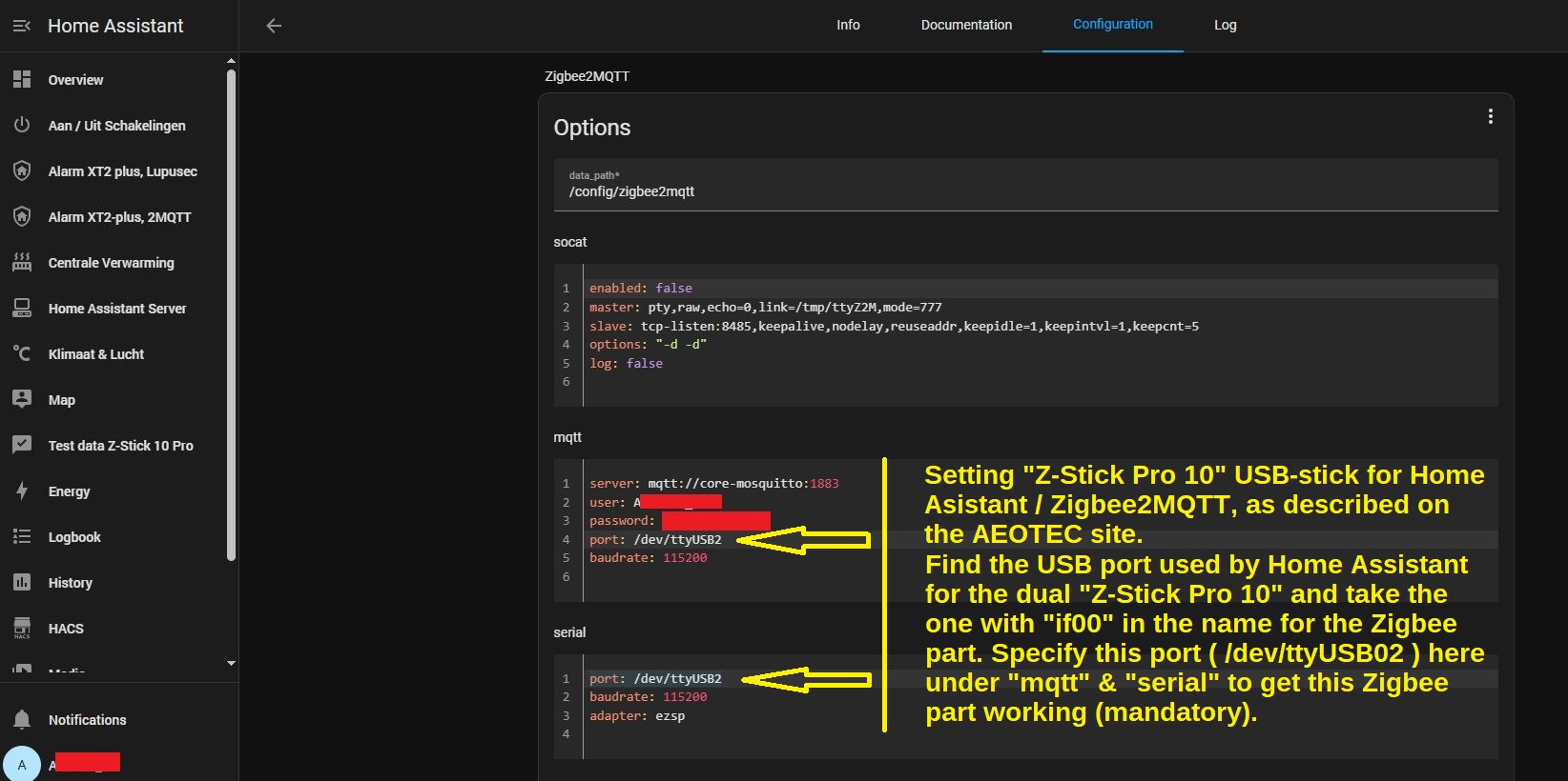

I had the same error message in the log of the Home Assistant (HA) Addon Zigbee2MQTT, being:
zh:ezsp:ezsp: Connection attempt 1 error: Error: Error Resource temporarily unavailable Cannot lock port
The error occurred after the update/upgrade to HA Operating System (HAOS) version 16 with an automatically restart of HAOS.

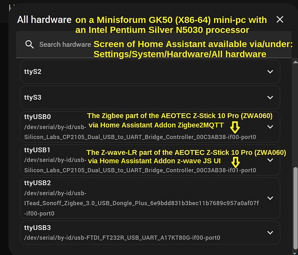

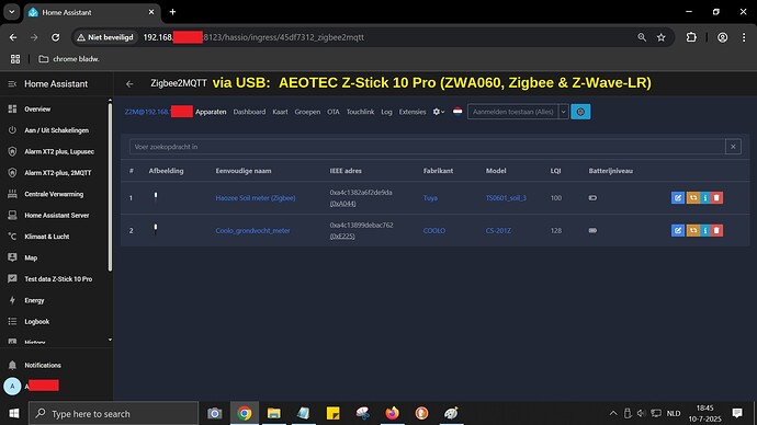

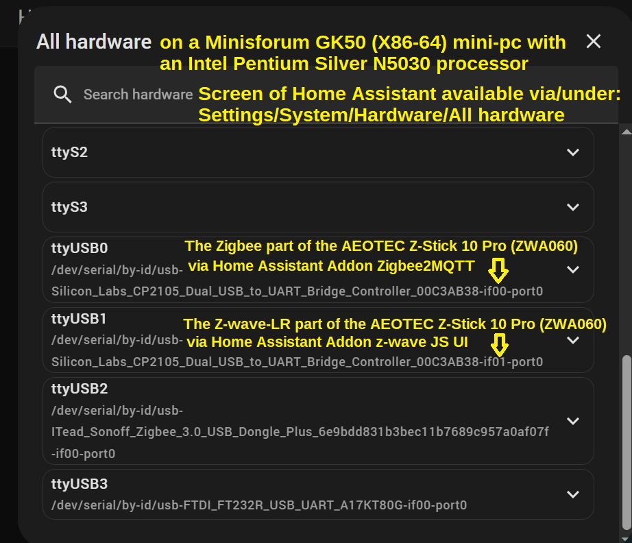

On my Minisforum GK50 mini-PC (is a X86-64 machine), I have HA with:
  • Sonoff USB-Zigbee-P stick assigned to to HA Zigbee (ZHA).
  • Dual (Zigbee & Z-wave-LR) “AEOTEC Z-Stick 10 Pro” (ZWA060),
    assigned to the HA Addon ZigbeeMQTT and to the HA Addon “Z-wave JS UI”.

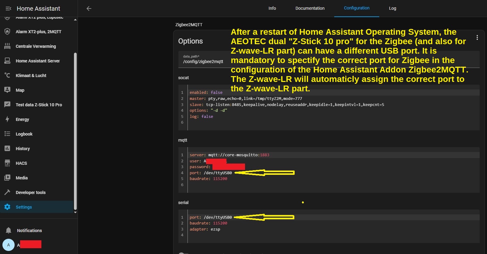

The cause is that under Zigbee2MQTT (I think), it is mandatory to specify the USB-port used by the USB Zigbee Coordinator (UZC). After a restart of HAOS the UZC was assigned to another USB-port. So I had to change the USB-port in my case from “/dev/ttyUSB2” to “/dev/ttyUSB0” in the configuration of the HA Addon Zigbee2MQTT.
After this change and the (re)Start of the HA Addon Zigbee2MQTT all worked fine.
PS,
For the HA Addon “Z-wave JS UI” the assignment of a new USB-port goes automatically !!
I did not have to “Disable” the Sonoff USB-Zigbee-P" to get the Zigbee2MQTT working !!
