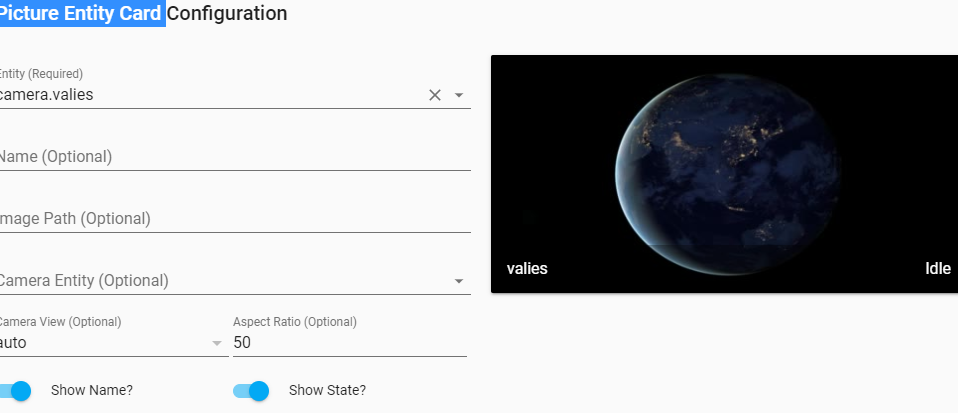

- Add picture entity card, thumb image show up
