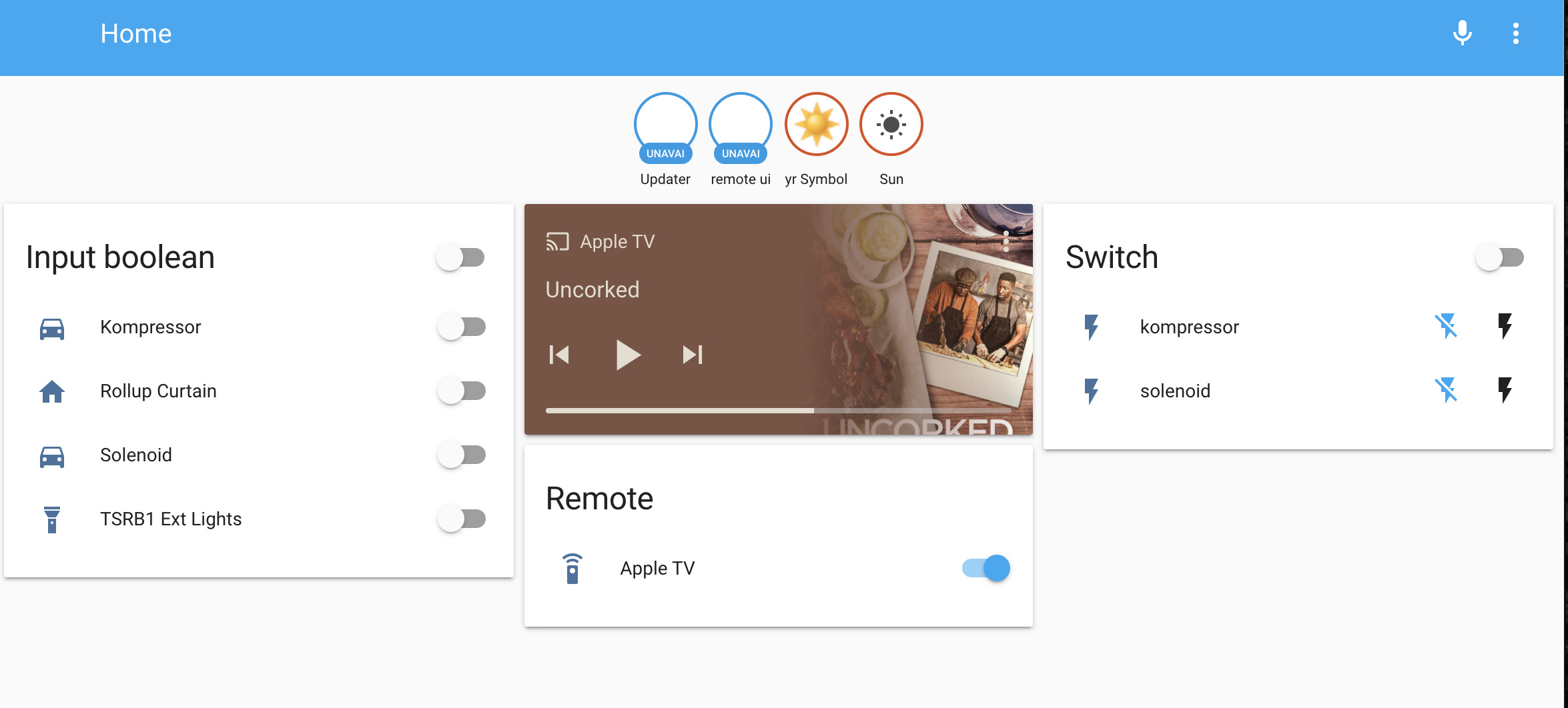

Im trying to control my roller curtain. I have it set up so that if it receives a 1 or 0, it activates the dc motor in one direction or another. If I add value of 1 it fails but if I add value of 0 it works:
But my toggle doesnt show up on my dashboard

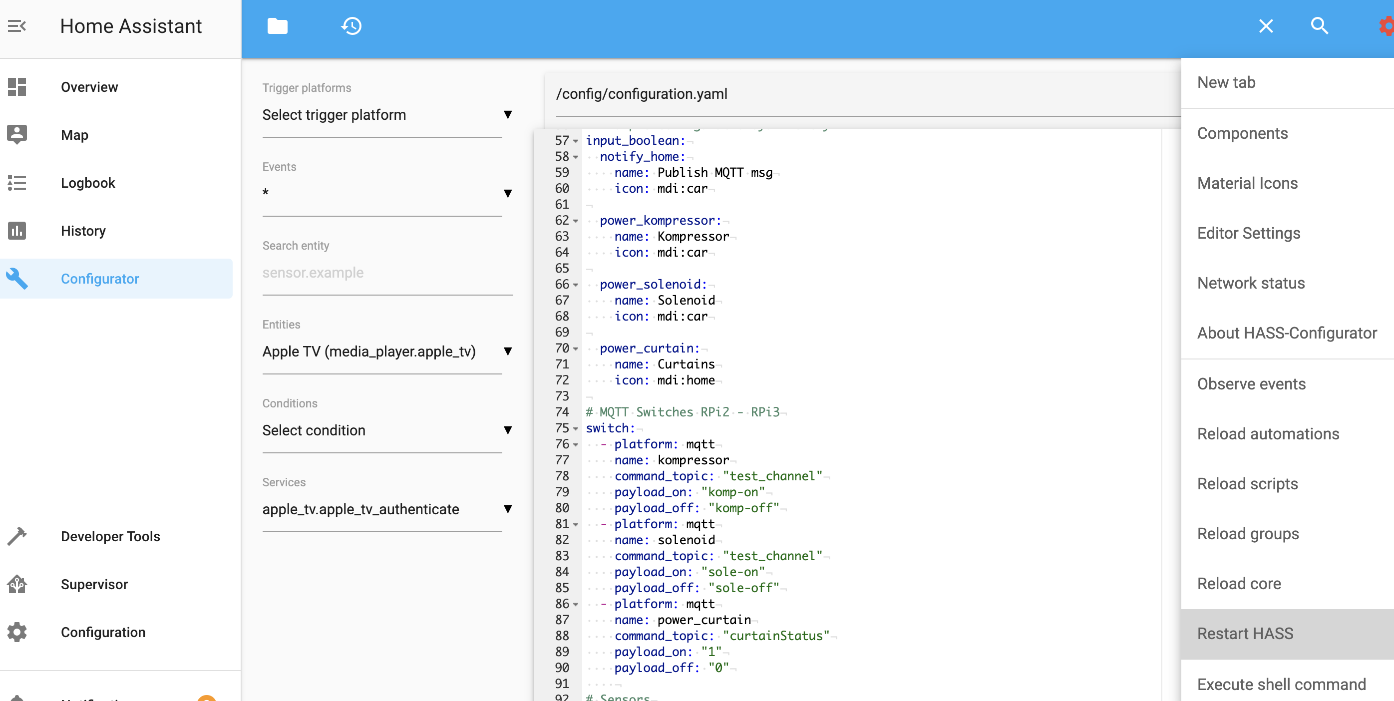

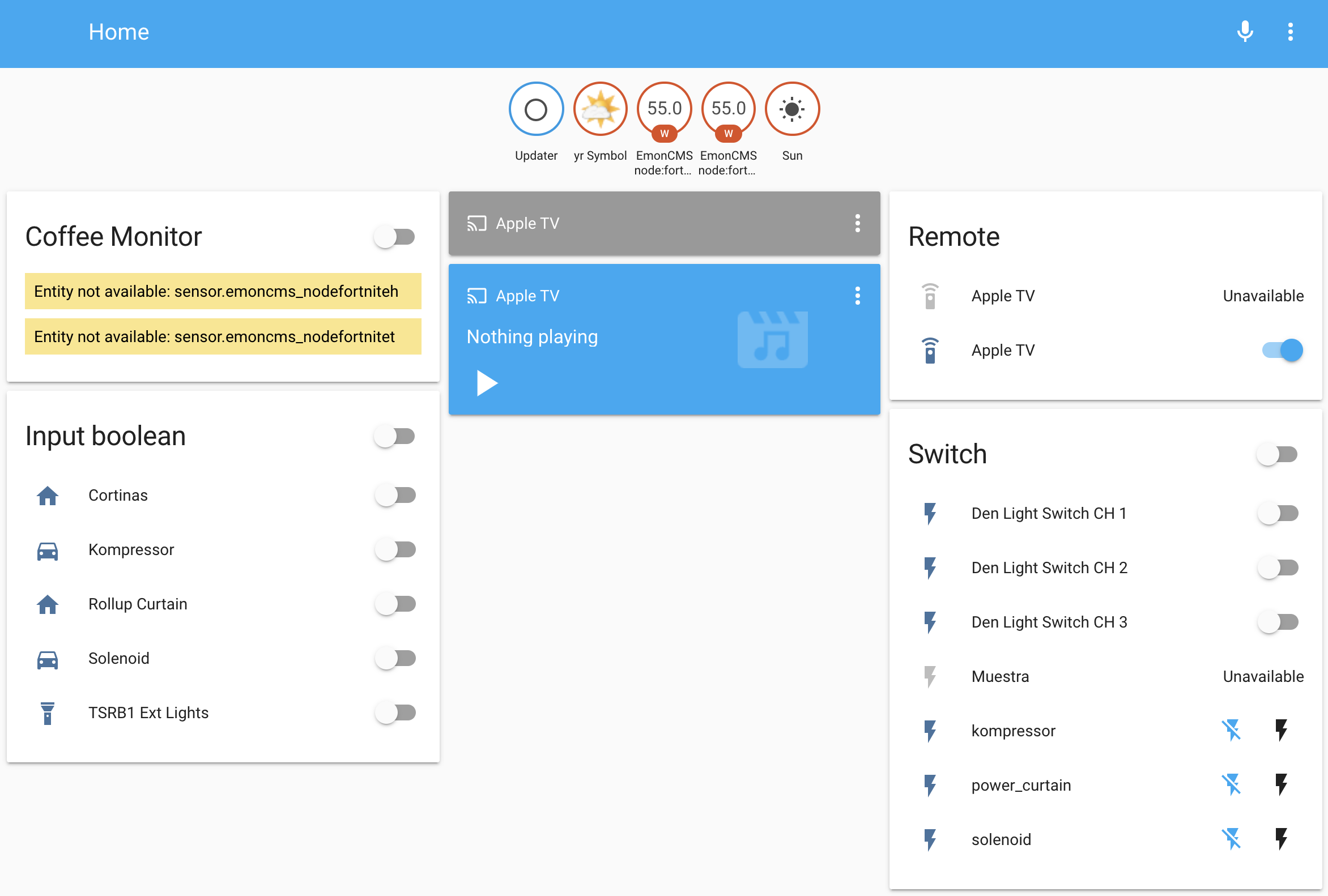

I changed the power_curtain command_topic to “test_channel” and after restarting, woah…a bunch of stuff changed. Not sure if it was because of the test_channel change. Let me try changing it back…
The only thing i did differently this time was that i found an option to Restart Hass in a sprocket wheel on the top left of the Configurator file editor and used that instead of the typical Restart Server option in the Hassio Configuration menu option…
ok so i changed it back to curtainStatus and it still shows up. So Im guessing this option:
Isnt quite the same as this option:
And even now something is off and not completely refreshed because if you take a look at my dashboard, i have:
  1. Cortinas input_boolean… which IS INDEED in my configuration.yaml
  2. Rollup Curtains input_boolean… which IS NOT in my configuration.yaml
  3. Muestra toggle switch… which IS NOT in my configuration.yaml
So something doesnt seem to be refreshing completely…
