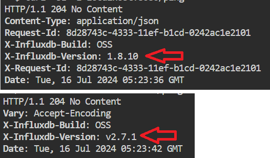

Now I want to switch to InfluxDB v2 and have installed this add-on with a different port in parallel:

In principle it works, but only the last few days (July) are exported. The “influx_inspect export” delivers a readable file. In this I looked at the epoch timestamps and found that only the last few days were being exported.
The file or files are created in about 1-2 seconds with both methods mentioned above and when exported it is only about 40 MB in size.
As I said, the DB actually contains 8 measurements over half a year.
