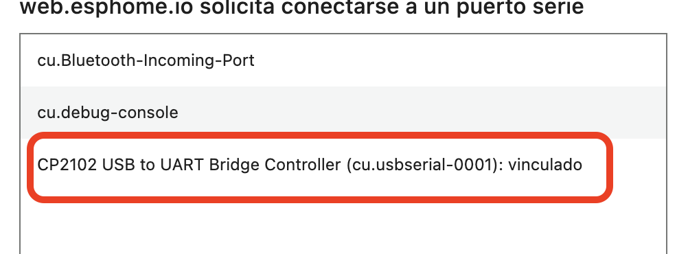

Thank you. I have another issue with the ESP32. The line marked in red in the image is blinking 8apperas-dissapears) so I can’t physically connect to the device on the ESPHome web. I installed all the drivers.
No idea. Bad cable? Something drawing current through your Esp32?
I tried different cables, and different PCs.
Did you press the boot button while inserting in the USB?
Yes, I did…
The device was corrupt. I bought a new one and everything is fine.
