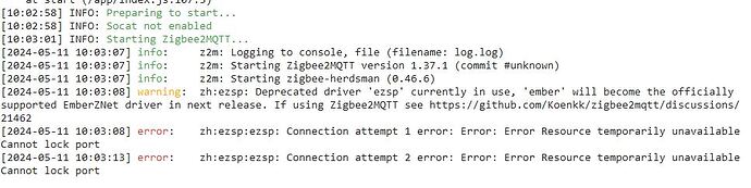

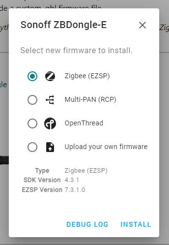

I have upgraded a sonoff Dongle-E with Webflash to version 7.3.x. Do I need Silicon Labs Multiprotocol?
my zigbee2mqtt does not start ![]()

Can I do something wrong when flashing?
I do it with the online flash.
and make sure to use a Zigbee only firmware
I can only use Zigbee (EZSP)
upload firmware is not running

Cannot lock port : something else is using the port, probably ZHA. Disable or remove ZHA. Or the OT Border router if you don’t have a OT Border router stick.
there are still two esp32 connected, but it doesn’t work without them either
ESP32 won’t interfere with your Zigbee stick. Check also if you don’t have the multi-protocol add-on installed. if so, remove it
