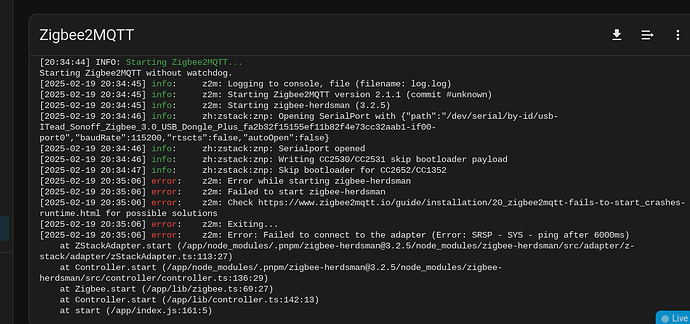

I am trying to set up Z2M and I keep getting the below errors in my logs and it will not start. I am trying to put it on Sonoff Zigbee Dongle 3.0 Plus-P. Any help I could get on getting this going I would greatly appreciate it. I have attached my logs. Tried to screenshot my configuration and it wouldn’t let me so I copied and pasted it in.
Socat:
enabled: false
master: pty,raw,echo=0,link=/tmp/ttyZ2M,mode=777
slave: tcp-listen:8485,keepalive,nodelay,reuseaddr,keepidle=1,keepintvl=1,keepcnt=5
options: “-d -d”
log: false
Serial
port: >-
/dev/serial/by-id/usb-ITead_Sonoff_Zigbee_3.0_USB_Dongle_Plus_fa2b32f15155ef11b82f4e73cc32aab1-if00-port0
adapter: zstack
