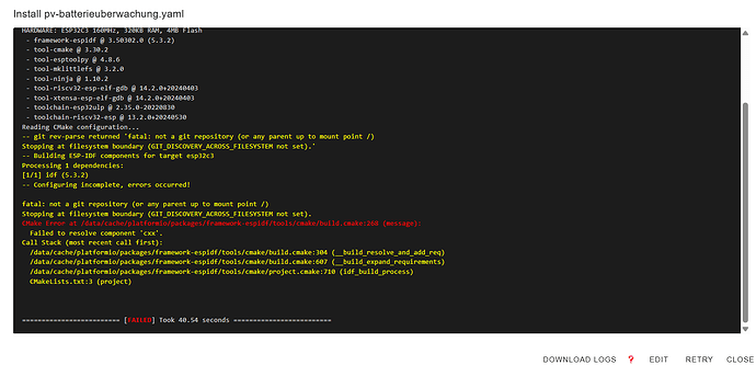

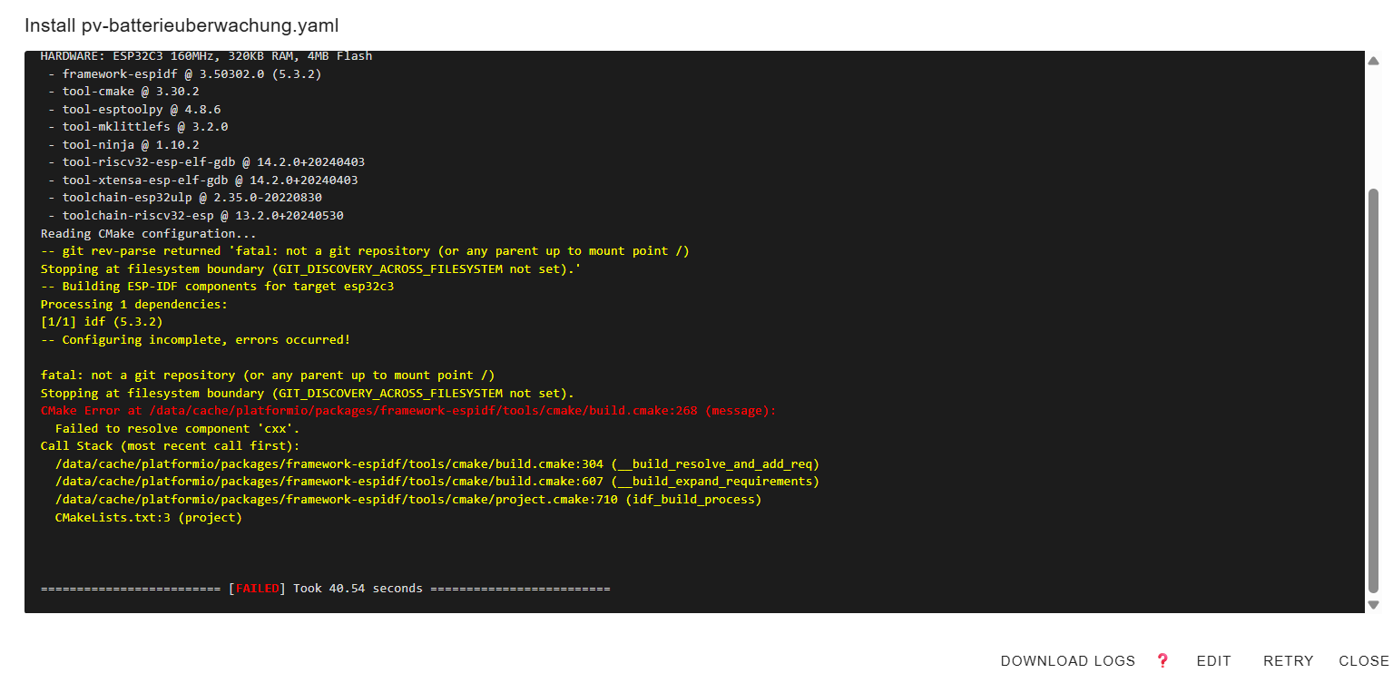

When i try to install a code on ESP32-C3 Supermini via ESPHome Builder i newly get an error message

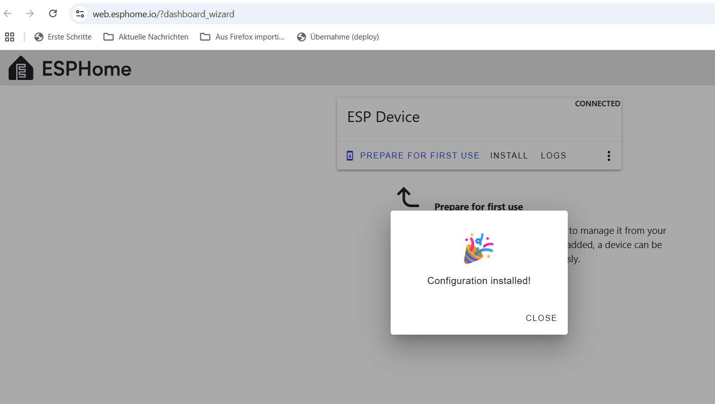

Before i used Web ESPHome to prepare the ESP for the first use.
Result

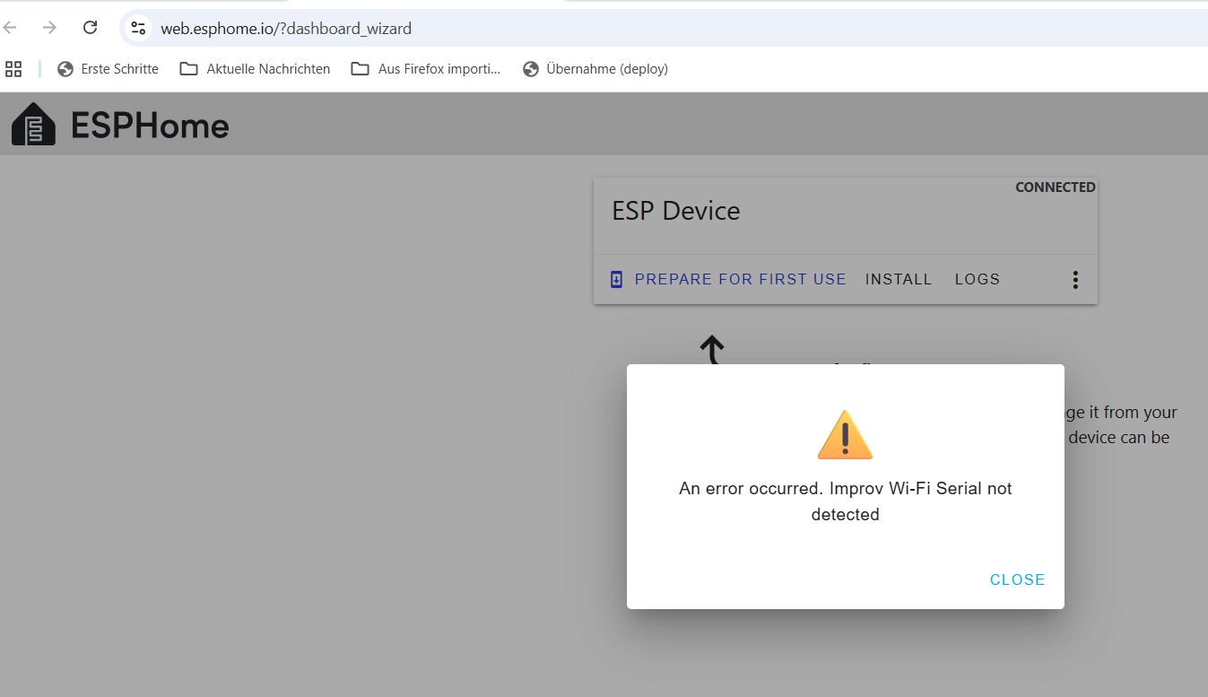

and
Any ideas?
Result
and
Any ideas?

The ESP is connected via USB… i think there is a problem with compiling → see yellow error message at the first picture.

You have wrong board.
Try with:
board: esp32-c3-devkitm-1
Now everything is working again. I reinstalled HA and restored the previously created backup. Didn’t work at first either.
Saw something about “platformio” in a log. Then I remembered that I had installed VSCode with the platformio extension. After I deleted the program and the extension, everything was ok again.
