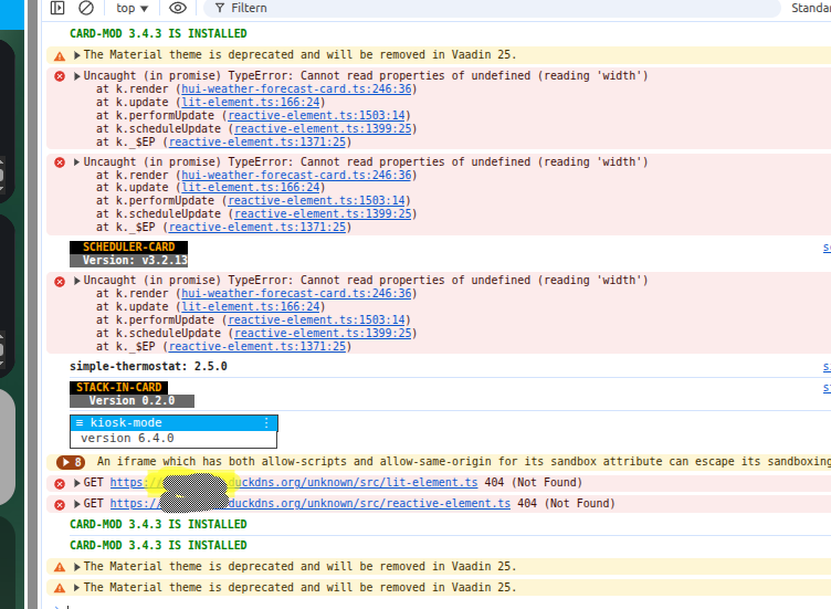

Hi all,
when i have a look to the debug console while showing my home dashboard i get some errors like in the screenshot.
The “hui-weather-forecast-card.ts:246 Uncaught (in promise) TypeError” ends in the line “if (this._sizeController.value.width === “very-very-narrow”) {”…
where width is not known. This error shows many times…
The …duckdns.org/unknown/src/lit-element.ts 404 (Not Found) only two times.
I’ve no idea and didn’t find anything in the web. Did you have the same errors?
There are no updates available…
Many thanks for your help.
see Weather Card has become "buggy" (shifts layout on load) · Issue #25775 · home-assistant/frontend · GitHub
there is an open issue , good if you’d join there
I just noticed it, so posted in the release thread of 2025.6 2025.6: Getting picky about Bluetooth - #195 by Mariusthvdb
